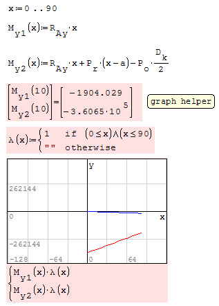

I was stuck in a ragged moment. I don't know how to draw a graph. Finally, a correct chart made in Excel.

You didn't define a, P, P.o, P.r, D.k.
After them defined with a number, a graph can appear.

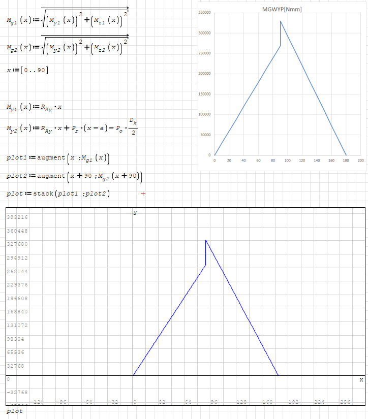

I have problems with ]the Mg1 (x) and Mg2 (x) graph, this one at the end.

All graphs plotted ...

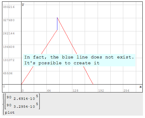

If I understood correctly, you are trying to plot graph picture in your file.
Here it is, you can download and check it from file below.

... for convenience: cumulative integration added.

Actually you don't need stack, augment, vectorize, etc.
It can also be plotted easily like this.
