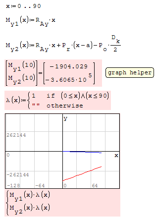

I was stuck in a ragged moment. I don't know how to draw a graph. Finally, a correct chart made in Excel.

Sorry I didn't save before posting.
That's right now.
I have problems with ]the Mg1 (x) and Mg2 (x) graph, this one at the end.
proba do wyslania.sm (50.09 KiB) downloaded 1309 time(s).
#4 Posted: 9/9/2022 2:07:58 PM
All graphs plotted ...
proba do wyslania.sm (55.25 KiB) downloaded 1270 time(s).

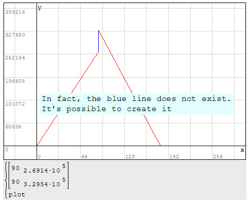

#5 Posted: 9/10/2022 9:19:39 AM
599 likes in 1,380 posts.
If I understood correctly, you are trying to plot graph picture in your file.
Here it is, you can download and check it from file below.
proba do wyslania.sm (46.79 KiB) downloaded 1275 time(s).

#8 Posted: 9/10/2022 8:56:52 PM
Actually you don't need stack, augment, vectorize, etc.
It can also be plotted easily like this.
proba do wyslania.sm (45.61 KiB) downloaded 1275 time(s).
