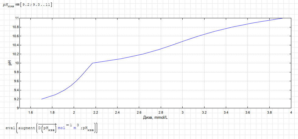

Some numbers can not be calculated for D().
Iteration doesn't concluded because "≉".
I have replaced it with an epsilon.
To plot it is better you eliminate units.
X-Y plot can but 2D plot cannot plot with units.
I had to put plot under an eval().
PreClean_fast.sm (63.85 KiB) downloaded 865 time(s).
