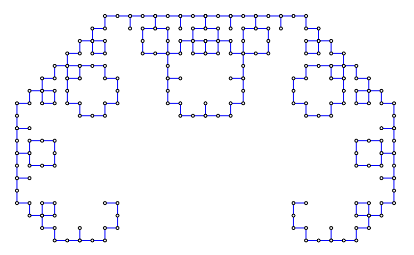

Can we create this in SMath.
I had a Mathcad-sheet but cannot find.

Hi OchkovVF,
Please check this post: https://en.smath.com/forum/yaf_postsm60787_Fractal-Tree.aspx#post60787

#3 Posted: 2023/10/26 20:20:57
No recollection it came from some sort of fractal.
For these two ... simple
Jean.
Pattern Valery.sm (5.03 KiB) downloaded 1252 time(s).

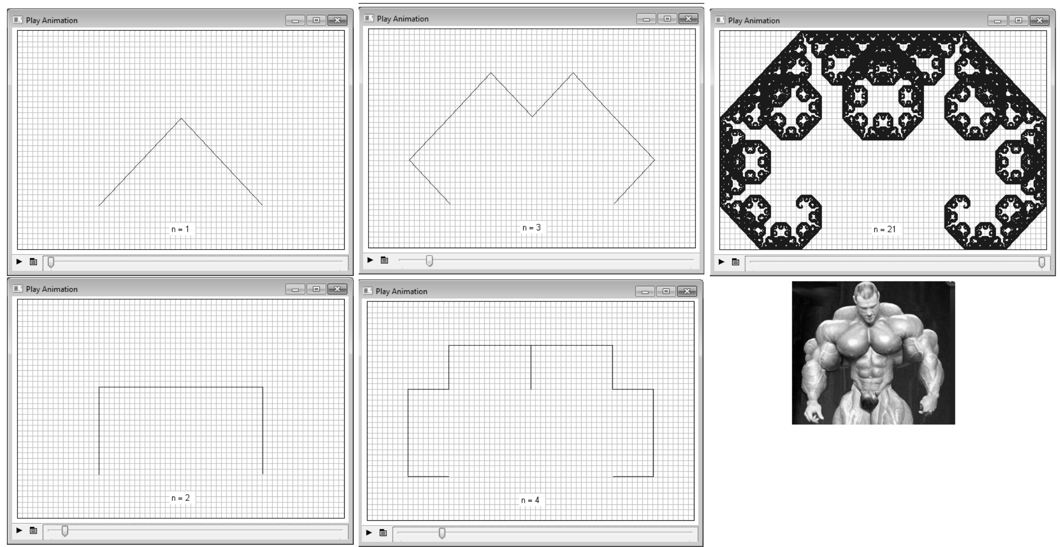

Я просил анимацию фрактала Леви.
А вы мне высыпали все, что у вас есть!

http://twt.mpei.ac.ru/MCS/Worksheets/Levy-curve.xmcd

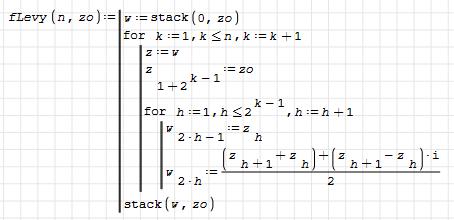

Here is the smath file for that mathcad example.
fractal_levy.sm (9.99 KiB) downloaded 1215 time(s).

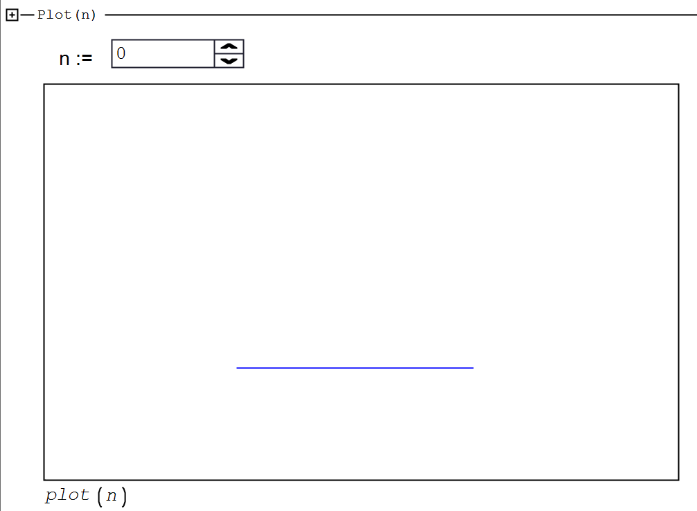

With n=0
Levy-Fractal.sm (12.3 KiB) downloaded 1221 time(s).
Did you seen Levi fractals by n<0 or n not integer?

Using complexes.
fractal_levy-complex.sm (8.7 KiB) downloaded 1248 time(s).
