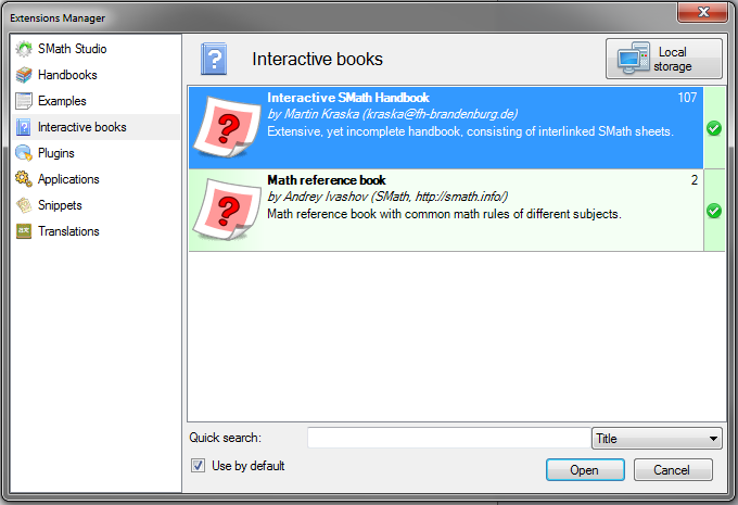

Also take a look at the Interactive SMath Handbook put together by Martin. You can find it by going to tools ->Plugins then clicking on Interactive Books in the left panel. I cannot remember if it's installed by default or not. If it's not there you can download it by further clicking on the "Local Storage" button and selecting "Online Gallery" and choosing to install it from there.
