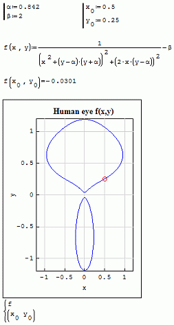

Maybe for the facility to add comments ? In this typical image, I can add as
much as desired to a accommodate each particular application.
I understand your point: Commercial Viewer does NOT capture the plot.

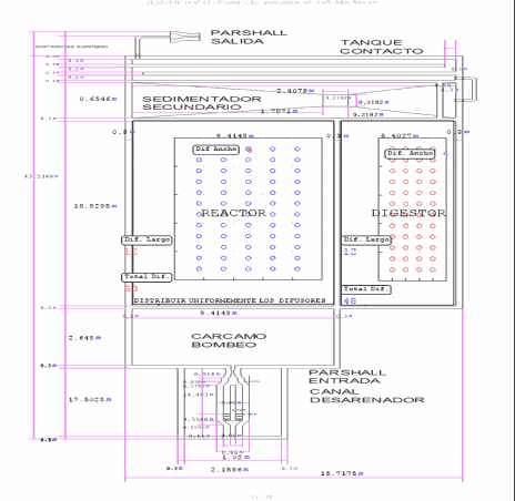

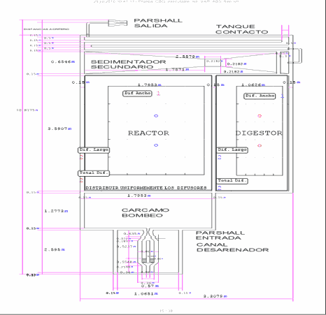

In my case, I am trying to develop a program to calculate and design Wastewater treatment Activated Sludge fine bubbles Plants .
The graphical X -Y plot , use it to graphically display the distribution of air diffusers .
Some screenshots
Small Plant (two diffusers).
A slightly larger plant (60 and 48 diffusers)
