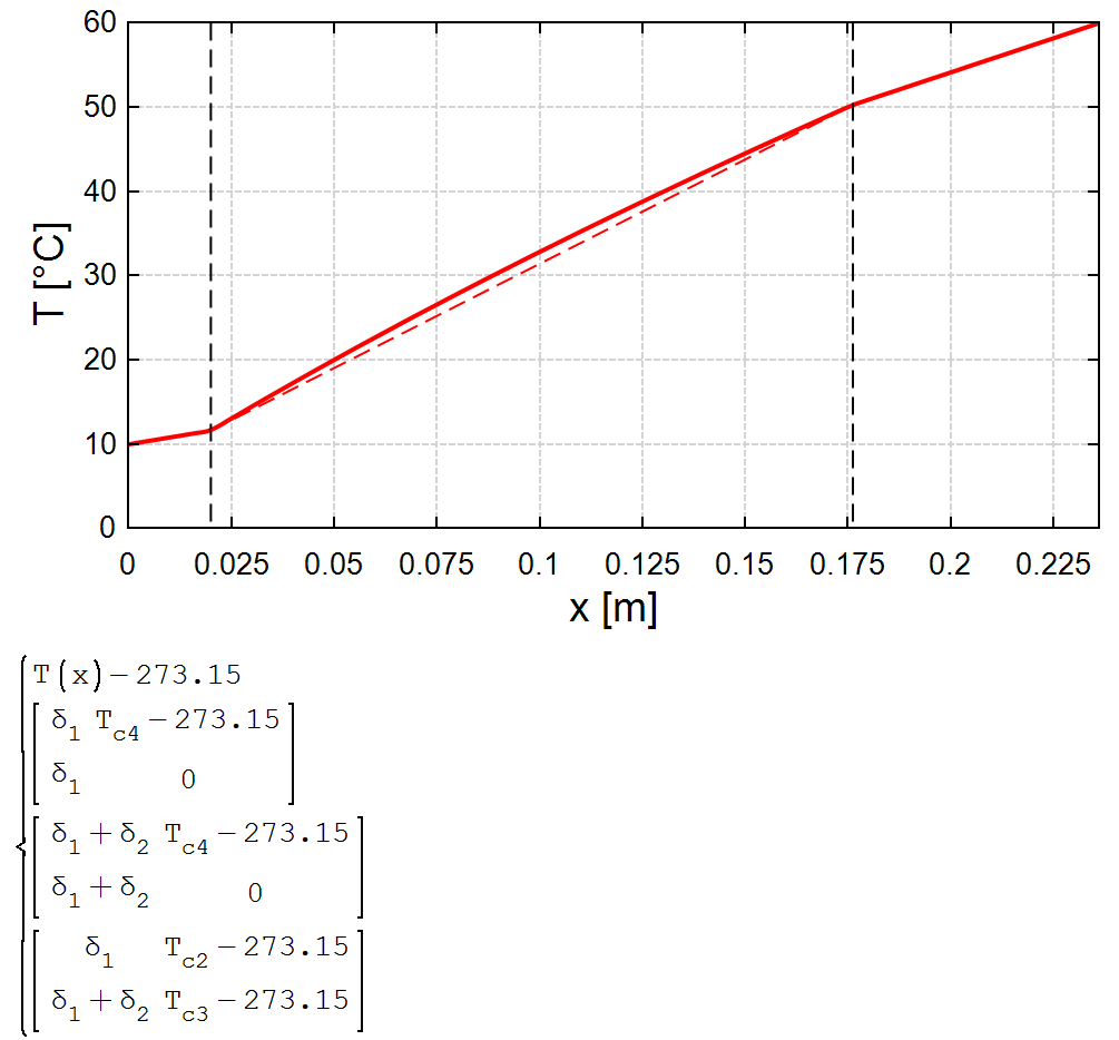

#4 Posted: 2023/7/15 07:17:49
1,355 likes in 2,271 posts.
Don't know if that is the simplest solution.
Stenka-3-eng.sm (58.13 KiB) downloaded 1213 time(s).
Valery Ochkov 2023/7/15 07:25:00

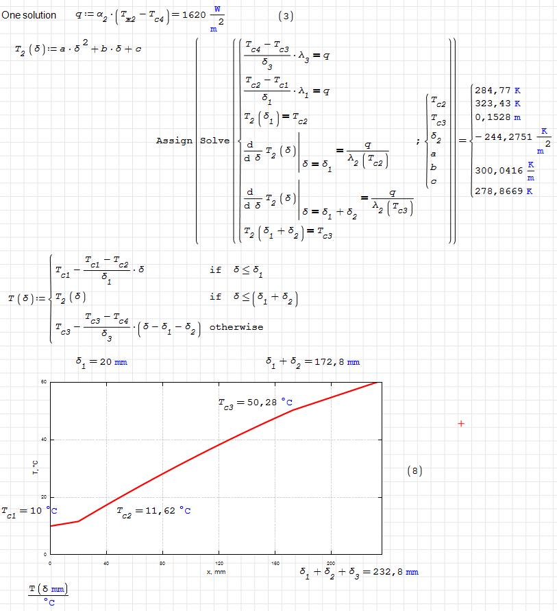

#8 Posted: 2023/7/16 05:40:21
Valery Ochkov
Valery Ochkov
66 likes in 690 posts.
I am trying to plot a temperature field in a three layer wall. There is no problem with the outer layers. But there is a problem in the middle layer - there should be a parabola, not a straight line. How to draw this parabola in the simplest way - with one formula. I know the hard way.
Stenka-3-eng.sm (60.64 KiB) downloaded 1227 time(s).
One solution from Alan Stevens
Stenka-3-Alan.sm (60.35 KiB) downloaded 1196 time(s).
