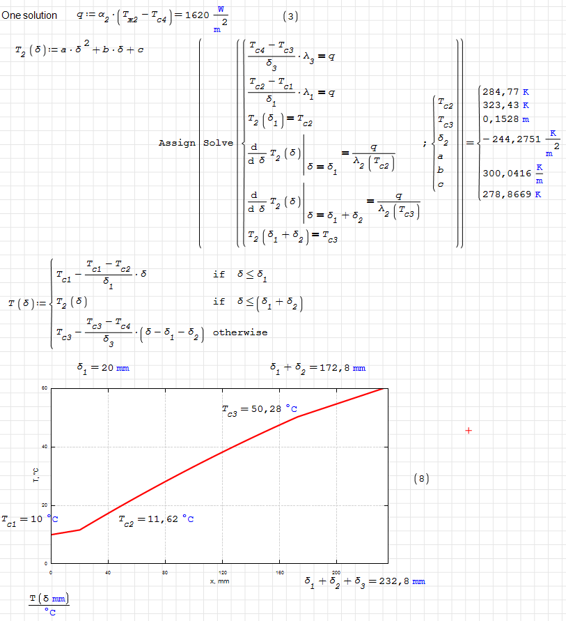

I am trying to plot a temperature field in a three layer wall. There is no problem with the outer layers. But there is a problem in the middle layer - there should be a parabola, not a straight line. How to draw this parabola in the simplest way - with one formula. I know the hard way.

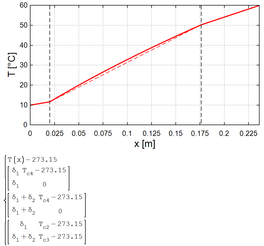

Don't know if that is the simplest solution.
Stenka-3-eng.sm (58,13 КиБ) скачан 1406 раз(а).

Valery Ochkov 15.07.2023 07:25:00

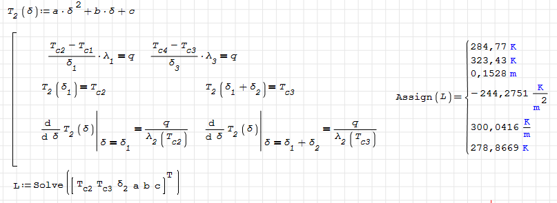

Version with mathcad block to collect the equations
Stenka-3-eng1.sm (59,5 КиБ) скачан 1425 раз(а).
Valery Ochkov 15.07.2023 07:40:00

One solution from Alan Stevens
Stenka-3-Alan.sm (60,35 КиБ) скачан 1376 раз(а).
