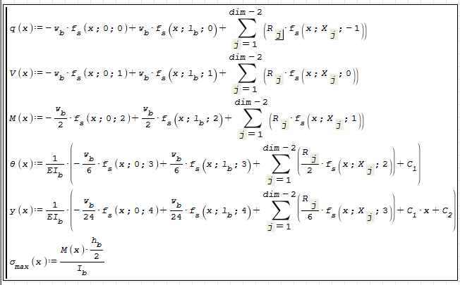

Dear all,
Some years ago, I worked out a beam calculation tool in smath, based on singularity functions.
The sheet worked flawless in an older SMath version, but the most recent SMath-incarnations result in problems: the error seems to originate with the summation command.
How do I get this program working again?
I attach the original files: thanks for any feedback!

Hello.
This is because of using "i" as a variable. Currently we have some issues regarding it. Will be addressed soon.
Simple change to fix your worksheet:
janclaeys 2018/3/19 08:16:00
#3 Posted: 2018/3/19 00:27:26
Hello.
Alternately: define the summations as local variable [SS 6179]
