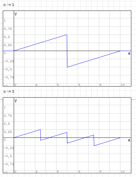

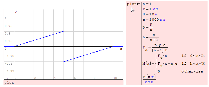

Hi guys.
I have come across an obstacle that I have not managed to find a satisfactory solution to. I am sure the problem is easy for the experts here, but the solution completely eludes me.
I want to make a function to plot bending moments caused by an eccentric load.
My aim is to make an equation/function that can plot a continuous bending moment diagram, while being able to scale how many loads is acting on the member.
Thank you for your time.
Best regards,
Hans Kristian.
test.sm (106.56 KiB) downloaded 608 time(s).

Hi Jean,
I want a function that will represent M(x) where the eccentric load P will be divided into n equal loads which are spaced out evenly along the length of the member.
Does that make sense?

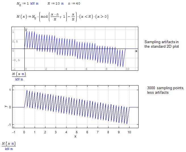

#6 Posted: 2019/11/5 18:47:15
1,308 likes in 2,221 posts.
Now with proper scaling
saw1.sm (5.15 KiB) downloaded 598 time(s).

#8 Posted: 2019/11/5 19:02:01
hanskl
hanskl
7 likes in 158 posts.
Thank you Martin, this is exactly what I am looking for!
Although your expression is both much simpler and much faster to compute, it does not look anything like what I had in mind.. Goes to show I have so much more to learn when it comes to SMath!
Cheers!

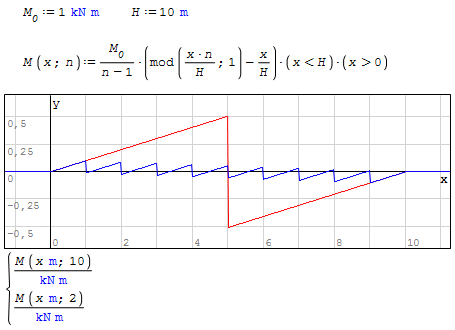

#9 Posted: 2019/11/5 21:47:57
1,078 likes in 1,749 posts.
Just for show why the Martin solution it's correct:
#10 Posted: 2019/11/5 22:39:50
Cheers!
The approach was purely phenomenological, i.e. to reproduce the plots, no matter what they mean. The idea was to combine a sawtooth function and a linear term (slope). There are many options to get a sawtooth, the modulo function being just one of them. Others are round(), Floor(), Ceil()... The remainder was guessing the coefficients in a heuristic trial and error fashion.

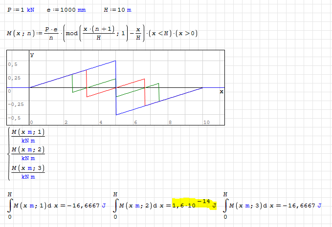

#12 Posted: 2019/11/6 06:50:02
hanskl
hanskl
Interessting. I have tweaked Martins equations - now n represents the number of loads, not the number of segments between loads/supports.
Any idea why the integral gives me this result? Also, my integral is 10x the value of yours.

#15 Posted: 2019/11/6 10:56:55
Smath native Simpson integrator ranges from:
1. Exact only few trivial cases.
2. Acceptable but depending upon Options/Calculations/Int. acc
set 1000 in your example.
3. Native Simpson may be TOTALLY useless.
Sooner or later, units system collide in the wall.
Discontinuous integration is poison in the soup.
