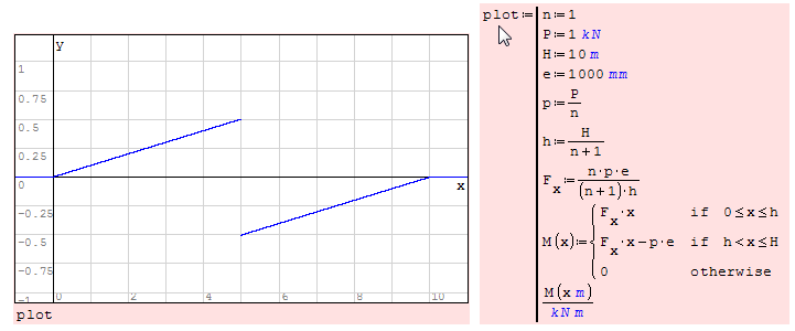

Hi guys.
I have come across an obstacle that I have not managed to find a satisfactory solution to. I am sure the problem is easy for the experts here, but the solution completely eludes me.
I want to make a function to plot bending moments caused by an eccentric load.
My aim is to make an equation/function that can plot a continuous bending moment diagram, while being able to scale how many loads is acting on the member.
Thank you for your time.
Best regards,
Hans Kristian.

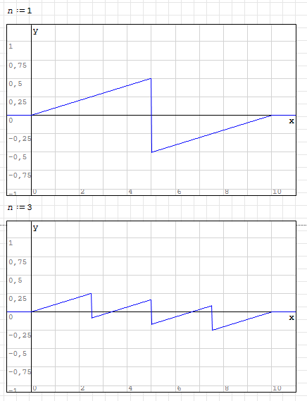

#4 Опубликовано: 05.11.2019 18:33:47
saw.sm (7,28 КиБ) скачан 1116 раз(а).

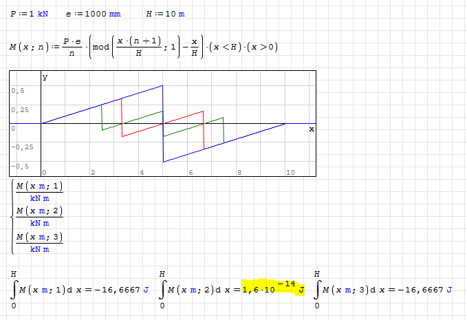

#6 Опубликовано: 05.11.2019 18:47:15
Now with proper scaling
saw1.sm (5,15 КиБ) скачан 1164 раз(а).

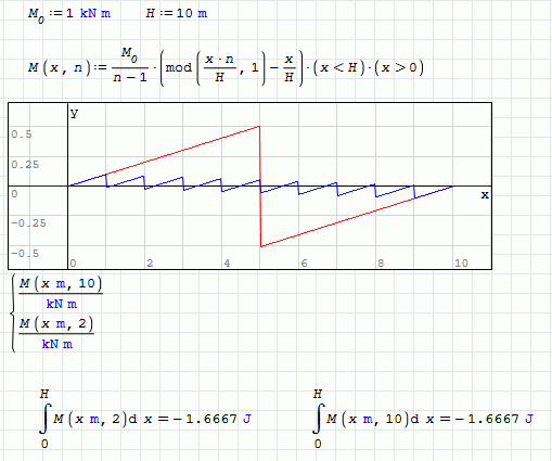

#8 Опубликовано: 05.11.2019 19:02:01
hanskl
hanskl
7 сообщений из 158 понравились пользователям.
Thank you Martin, this is exactly what I am looking for!
Although your expression is both much simpler and much faster to compute, it does not look anything like what I had in mind.. Goes to show I have so much more to learn when it comes to SMath!
Cheers!
#9 Опубликовано: 05.11.2019 21:47:57
Just for show why the Martin solution it's correct:
#10 Опубликовано: 05.11.2019 22:39:50
Cheers!
The approach was purely phenomenological, i.e. to reproduce the plots, no matter what they mean. The idea was to combine a sawtooth function and a linear term (slope). There are many options to get a sawtooth, the modulo function being just one of them. Others are round(), Floor(), Ceil()... The remainder was guessing the coefficients in a heuristic trial and error fashion.

#12 Опубликовано: 06.11.2019 06:50:02
hanskl
hanskl
Interessting. I have tweaked Martins equations - now n represents the number of loads, not the number of segments between loads/supports.
Any idea why the integral gives me this result? Also, my integral is 10x the value of yours.
Best regards,
