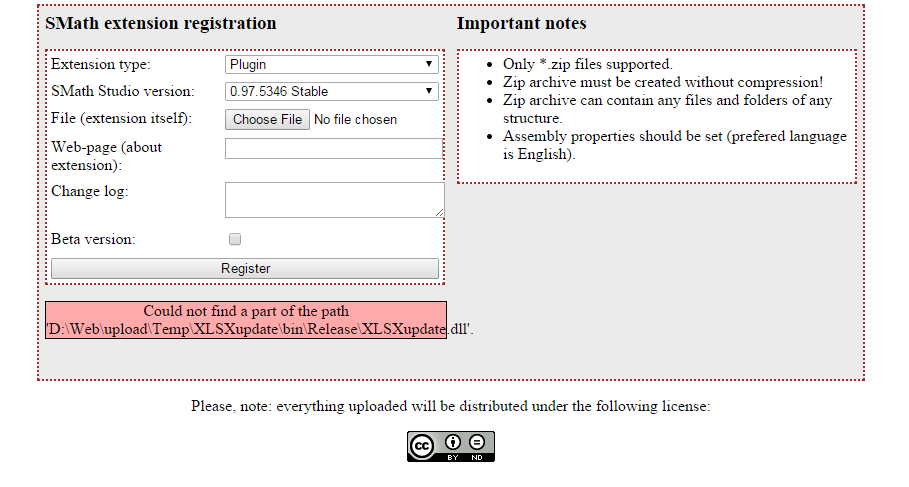

I tried updating my EXCEL plugin to the extension manager with no success.It seems that things have changed, and instead with uploading zipped DLL (which was quite easy, now I need to work with "SMath Release Manager", which i am not familiar with..
Could you help me out? What do I need to do to update the .dll file to the extension manager?
Thank you
- Upload your project into the SVN server;
- Modify your *.csproj/*.vbproj to link the SMath libraries (f.e. you can look here or here);
Important: The solution file name must be equal to folder name;If your plugin uses P/Invoke to call unmanaged APIs, you have to use the AfterBuild field at the end of the file:<PropertyGroup> <!-- Relase -> SMath Relase Manager --> <SMathDir Condition=" '$(SMathDir)' == '' AND '$(Configuration)' == 'Relase' ">..\..\..\Main\SMathStudio\canvas\bin\Debug</SMathDir> <!-- Debug -> local use --> <SMathDir Condition=" '$(SMathDir)' == '' AND '$(Configuration)' == 'Debug' ">C:\Program Files (x86)\SMath Studio</SMathDir> </PropertyGroup> <PropertyGroup Condition=" '$(Configuration)|$(Platform)' == 'Debug|AnyCPU' "> <StartAction>Program</StartAction> <StartProgram>$(SMathDir)\SMathStudio_Desktop.exe</StartProgram> </PropertyGroup> <ItemGroup> <Reference Include="SMath.Controls"> <HintPath>$(SMathDir)\SMath.Controls.dll</HintPath> <Private>False</Private> </Reference> <Reference Include="SMath.Manager"> <HintPath>$(SMathDir)\SMath.Manager.dll</HintPath> <Private>False</Private> </Reference> <Reference Include="SMath.Math.Numeric"> <HintPath>$(SMathDir)\SMath.Math.Numeric.dll</HintPath> <Private>False</Private> </Reference> <Reference Include="SMath.Math.Symbolic"> <HintPath>$(SMathDir)\SMath.Math.Symbolic.dll</HintPath> <Private>False</Private> </Reference><Target Name="AfterBuild"> <Copy SourceFiles="WriterManager\Resources\Hunspellx64.dll" DestinationFolder="$(OutputPath)" ContinueOnError="false" /> <Copy SourceFiles="WriterManager\Resources\Hunspellx86.dll" DestinationFolder="$(OutputPath)" ContinueOnError="false" /> </Target> - Use BUILD to compile your solution; a LOG file will be produced and you can notice errors and warnings, if any;
- Use PUBLISH to make available the plugin in the Extensions Manager;
On a side note - what will happen to my existing plugin in the extensions manager?
Thanks
WroteOn a side note - what will happen to my existing plugin in the extensions manager?
The existing plugins still remains in the system and are available for the older version of SS (if you publish the newer plugins for a target version greater than that chooen for the previous plugins).
As mentioned in the attachment in the first post you can access them from this link: http://smath.info/upload/default.aspx.
Could please peak through this warning and let me know whether it is substantial (i.e. whether I need to do anything to fix it). Thank you!!!
30-10-2015 09:34:02. Extracting sources from repository...
30-10-2015 09:34:06. - Done. (SVN rev. [1409])
30-10-2015 09:34:06. ------------------------------
30-10-2015 09:34:06. [Warning!] SMath Studio binaries found included into SVN repository. Please consider to reference them from outside of the solution!
30-10-2015 09:34:06. - {SourcesDir}\smath\canvas.dll
30-10-2015 09:34:06. - {SourcesDir}\XLSXupdate\bin\Debug\canvas.dll
30-10-2015 09:34:06. - {SourcesDir}\XLSXupdate\bin\Release\canvas.dll
30-10-2015 09:34:06. - {SourcesDir}\smath\ioman.dll
30-10-2015 09:34:06. - {SourcesDir}\XLSXupdate\bin\Debug\ioman.dll
30-10-2015 09:34:06. - {SourcesDir}\XLSXupdate\bin\Release\ioman.dll
30-10-2015 09:34:06. - {SourcesDir}\smath\NuLib.dll
30-10-2015 09:34:06. - {SourcesDir}\XLSXupdate\bin\Debug\NuLib.dll
30-10-2015 09:34:06. - {SourcesDir}\XLSXupdate\bin\Release\NuLib.dll
30-10-2015 09:34:06. - {SourcesDir}\smath\SyLib.dll
30-10-2015 09:34:06. - {SourcesDir}\XLSXupdate\bin\Debug\SyLib.dll
30-10-2015 09:34:06. - {SourcesDir}\XLSXupdate\bin\Release\SyLib.dll
