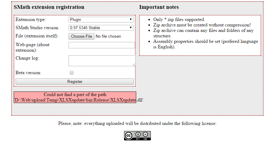

#11 Опубликовано: 15.04.2015 21:59:51
Alexander O. Melnik
Alexander O. Melnik
I Have attempted to upload a plugin and received following error. What am I doing wrong?
Thanks!

#12 Опубликовано: 30.10.2015 02:49:05
Alexander O. Melnik
Alexander O. Melnik
Hi Andrey,
I tried updating my EXCEL plugin to the extension manager with no success.It seems that things have changed, and instead with uploading zipped DLL (which was quite easy, now I need to work with "SMath Release Manager", which i am not familiar with..
Could you help me out? What do I need to do to update the .dll file to the extension manager?
Thank you

#17 Опубликовано: 31.10.2015 08:39:42
Seems that your issues were fixed by Andrey
