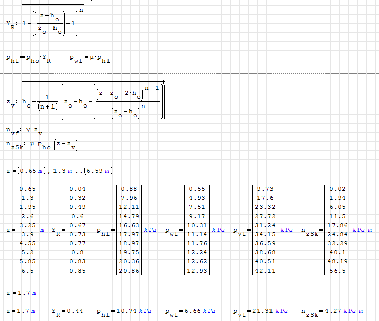

I want to create a file to calculate pressures in a cylindrical silo with respect to EN standards. I have entered the datas and formulas needed to calculate. Bu the programe can't calculate a formula.
I tried it on the mathematica and it worked. How can I solve this issue?

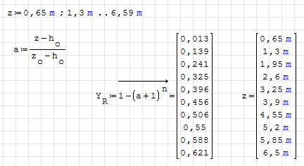

#2 Опубликовано: 24.08.2016 12:47:41

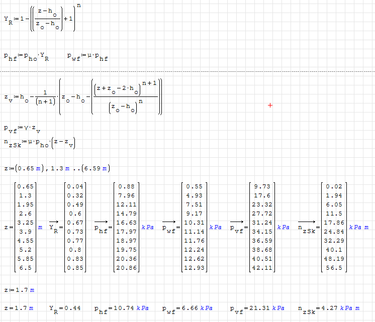

Hello Berk,

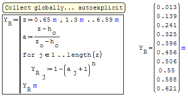

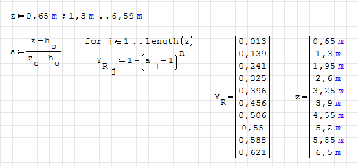

To accomplish you task you have to loop through the values of the input vector; to do this you can use the function vectorize(...) or a loop (for(...), while(...));
vectorize:
loop:

#4 Опубликовано: 24.08.2016 16:40:21

Dear Davide,
Thank you for your reply. It is working with the vectorize function but why it should be like that? I couldn't understand. For example variable "a" has values when you press equal without any vectorize function.

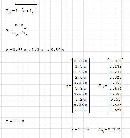

#5 Опубликовано: 24.08.2016 21:04:34
Hello Berk,
Just like this:
In SMath while you are working with matrices "raise to power" it is a shorthand for matrix multiplication/inverse multiplication -> it works just when the exponent is an integer;
moreover when matrices are vectors (column matrices), instead of giving an error because dimensions of matrices are wrong, a special feature allows to the product to be the "dot product" (thus vector^power is the sum of its elements each one raised to power's value);
To apply scalar math to matrices/vectors you have to use vectorize(), programming (loops) or also you can use systems - sys(..) function.

I have done this calculations by vectorize function. I need random value in this equation. For example I need YR at z 1,5 m. How can I get that value to be used in a different equation?

#10 Опубликовано: 25.08.2016 12:15:06
This should works:
en%201991-4(3).sm (596,43 КиБ) скачан 1409 раз(а).

#12 Опубликовано: 29.08.2016 10:47:14
Mike Kaganski
Mike Kaganski
Berk,
that's because of the order of declarations in your file. Please notice that Davide defined formulas first, and later defined the variables that constitute the formulas. This way, when the formulas were defined, the meaning of its constituents was undefined, so it stayed as is: names. When later below, after all variables were set, you tried to get the Y.R value, SMath took the formula for Y.R, substituted all variables in it with their already-known values, and gave you the result for this set of values. After that, you re-defined some of variables, tried to get answer, and SMath repeated substitution in the formula, giving you the new answer.
But in your file, you define variables first, then define formula for Y.R. This way, at the Y.R definition, SMath already knows all variable values, so it stores them in the Y.R definition instead of their names. All later modifications of those variables won't have impact on what is inside the Y.R, so you won't see new results.
But you may use functional syntax instead, something like
Y.R(z):vectorize(1-(({z-h.o}/{z.o-h.o})+1)^n)
, to be independent on the declarations order.

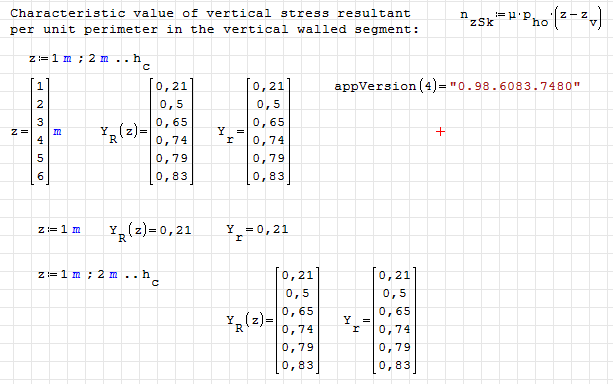

I have tried what you said in the attached file. I have put z range below the formulas. And I have created function of z with same variable ( both formulas are on the sheet now). But it couldn't calculate the results now with range.en 1991-4 (z).sm (602,6 КиБ) скачан 1283 раз(а).
About your latest attachment:
  1. Set n optimization to numeric on his definition (possible issue on exponentation of unit to check from smath side)
  2. You have renamed Y.R to Y.r (lowercase) - restore it (there's no name's conflict between functions and variables) or update the name inside the definition of p.hf

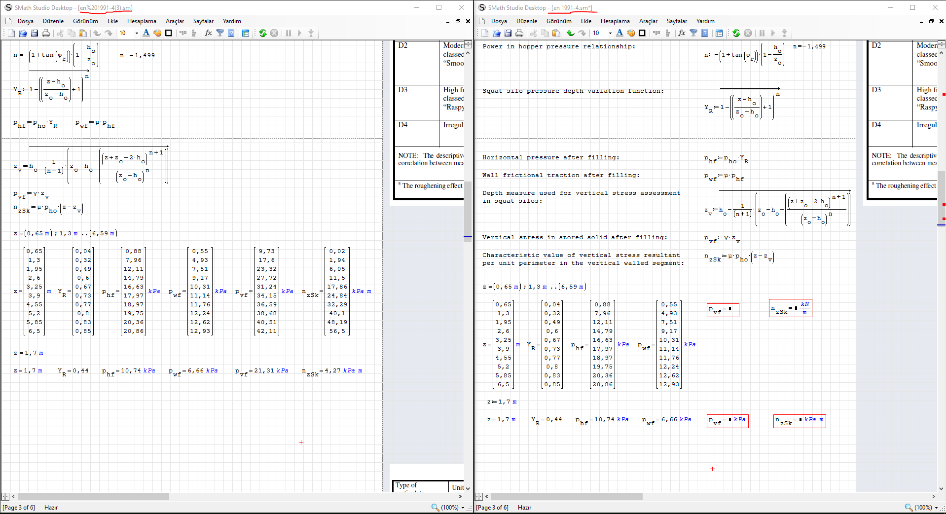

Thank you again, I just wanted to clarify that Y.r was just for demo. To try two methods simultenously. I have written that it is now working on my home notebook but I behave to early.
I have put two files tiled and screenshoted. As you can see all the things are same for both files (left is yours). But mine is not computing. I have just written the explanations of the variables only.
#18 Опубликовано: 29.08.2016 20:43:54
Mike Kaganski
Mike Kaganski
Thank you mikekaganski,
But I am really exhausted. I can't figure it. When I say "ok" now finally, then other issue appears on other place. I thank the author for this program as it is free and capable, I think I am not able to use it efficiently. I started to copy all the text and formulas to mathcad again which is a time consuming process but I can't find any other better way unfortunately.
Please see the attached 1 and 2.png sequentially and 3 and 4.png sequentially. As I understand from numeric, I entered "n" manually after knew the result, then it worked. All the calculations were done and there were no error. The expression at the bottom were ok. Then I deleted "z" value at top of the sheet which was entered to do a trial to see results. Then at the bottom, latests equations gave error.
I tried in another sheet with Y.R(z), it was good at beginning but then it gave an error again when the equations arise.
