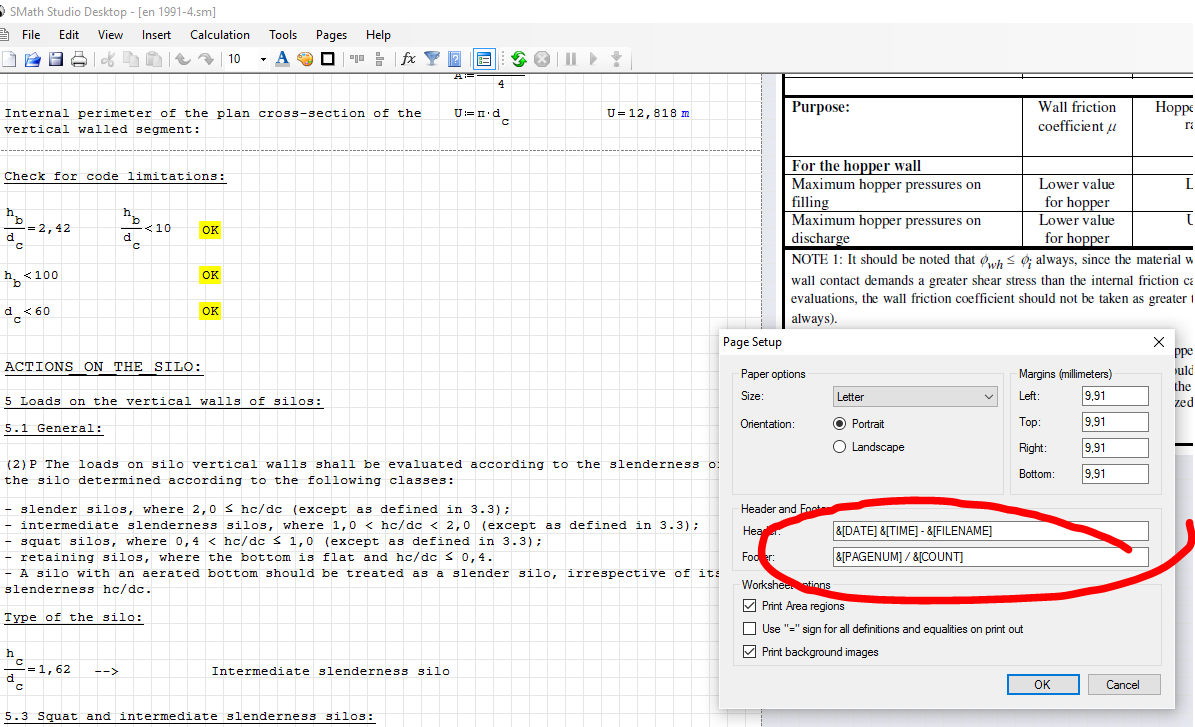

WroteYou can do like in Mathcad 11 => make an Smath work sheet template.
Example: in the right bottom corner your company cartouche.
cartouche: logo, document, designed by ... date not needed because
auto-dated in the header, auto-paging in the footer.
Try it

I don't know how to make ws template. I was using a Turkish program based on mathcad. But I don't know which version of mathcad was based on. The program is out of date now and not supported. So I don't know how mathcad setup was.
I suppose there must be some tags to add the below fields to have images maybe.

I couldn't manage to put a logo on top of the sheet. I think there must be a tag like &[IMAGE] which is similar to &[DATE] or a visual editor. Is it only way to put a background that has logo on top?
WroteI couldn't manage to put a logo on top of the sheet. I think there must be a tag like
Yes, there is way in Mathcad 11. I lost the code because it has limited interest.
The logo image must be not higher in size than the header text, otherwise it could
be 1" ... making the print horribly messy.
If you want your logo at the top left of the work sheet: just paste it here.
If your logo is not too big, then on right, add some lines of text [author, project
short description ...] Don't put date here, when saved, Smath dates in the header.

Ok thank you, I will add background with header to the sheet. That's the only way I could manage. But I have to make some arrangements because all the text is now beyond the image on background.
WroteOk thank you, I will add background with header to the sheet. That's the only way I could manage. But I have to make some arrangements because all the text is now beyond the image on background.
Something you don't catch: bacckground is over the entire work sheet.
Delete my logo, paste yours ... that's it .
Here is the code to upload an image, Smath does not take in header.
WroteWroteOk thank you, I will add background with header to the sheet. That's the only way I could manage. But I have to make some arrangements because all the text is now beyond the image on background.
Sorry for the dumb question: how to use this code?
