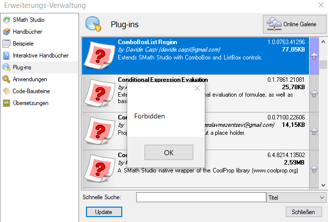

since the new Update i can't update or install Plug-ins. Is it because of the basic version i am using or is there on program error?

Re-login to your account from Smath.
Valid only if account is sufficient.
That should do the trick.

since the new Update i can't update or install Plug-ins. Is it because of the basic version i am using or is there on program error ?
Yesterday, I was Solver 30405
Error messages eternized about Maxima not available
Shut the box, restart Smath ... Oh! new version.
Open the dialog box, red down all conditions,
most important down to last line
Accept ... download ... install
All fine ... 30405 is now "1.1.8763.0"

Thank you @overlord. I had to repair the program and now it works.
But one plugin (TableRegion) don't work. Does the TableRegion only works in pay-accounts?

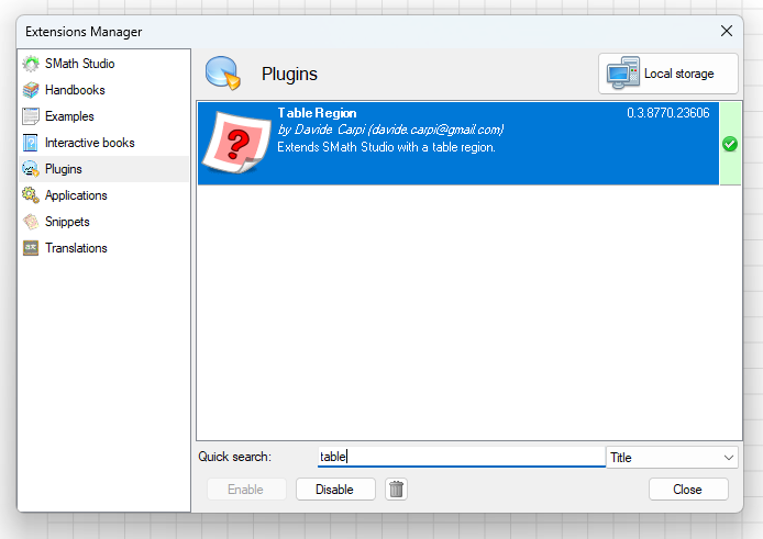

#7 Опубликовано: 15.01.2024 19:06:27
Hello [userlink]Thilo[/userlink]
The plugin should work for everyone in the latest SMath Studio, this is the version that should be listed in your extensions manager.
