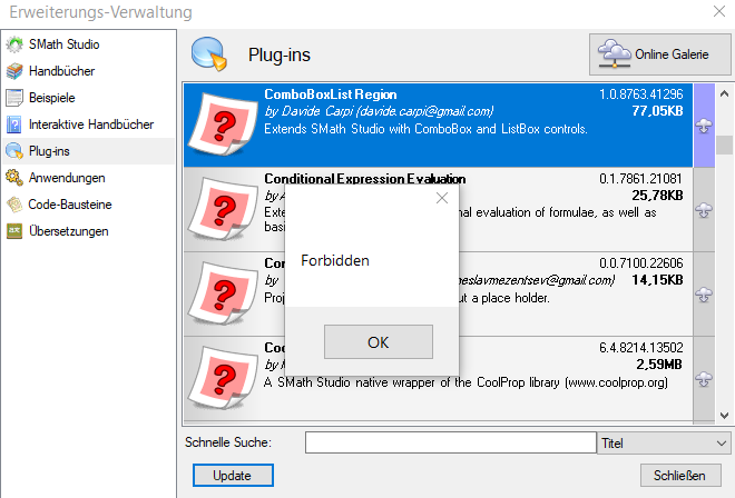

#1 Posted: 1/11/2024 9:48:22 PM
Thilo Schönherr
Thilo Schönherr
0 likes in 6 posts.
since the new Update i can't update or install Plug-ins. Is it because of the basic version i am using or is there on program error?

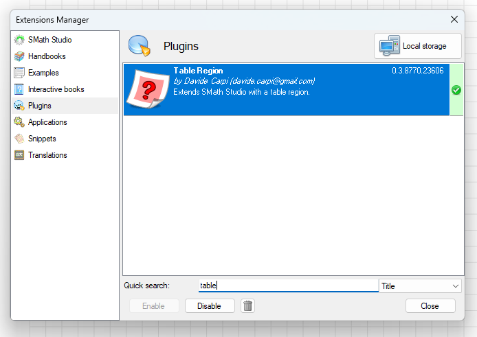

#7 Posted: 1/15/2024 7:06:27 PM
1,443 likes in 2,936 posts.
Hello [userlink]Thilo[/userlink]
But one plugin (TableRegion) don't work. Does the TableRegion only works in pay-accounts?
The plugin should work for everyone in the latest SMath Studio, this is the version that should be listed in your extensions manager.
