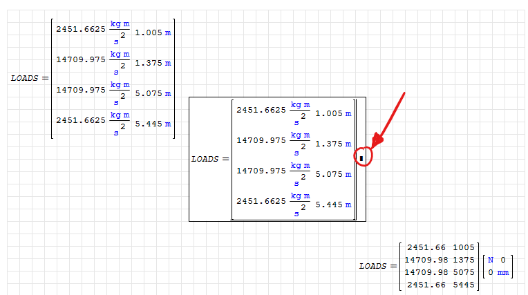

I created a dynamic matrix as T := matrix(2, cols(T1)). The values of the T1 matrix have units [MPa]. The values have to be rewritten to T where they meet certain requirements. But values of the "new" matrix T have units [kg/m*s2]. Is it possible change thise units to [MPa]? Any attempt to change units fails because the matrix T is computed.
Thank for any advice
Jadalbert
Not sure if I understood but you could show whatever unit is suitable (and consistent) by changing the unit of measure in the displayed results.
Same you would do with a single result, you can change the displayed unit in the black rectangle after results.. only difference from a single formula, is you need to use adiagonal matrix with proper units in proper positions.
At least, this is what I'm often doing to have a clearer view.
Some other users on the forum don't like using/displaying units at all, but that's another separate and recurring topic I guess.

It works! Tkank You.
In my case now it looks like:
T := [1 2 3 4 ...] MPa
and that is what I wanted.

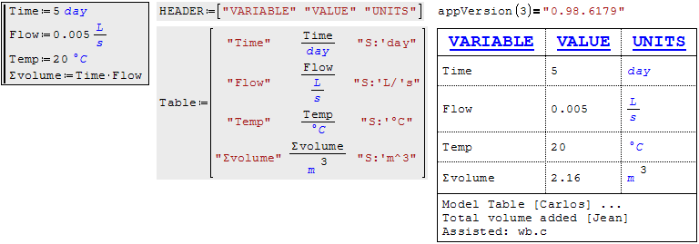

A vector of values can be associated with units.
A data table will have columns units in the header or row wise.

#6 Опубликовано: 07.12.2020 09:37:01
... suggestive examples.
