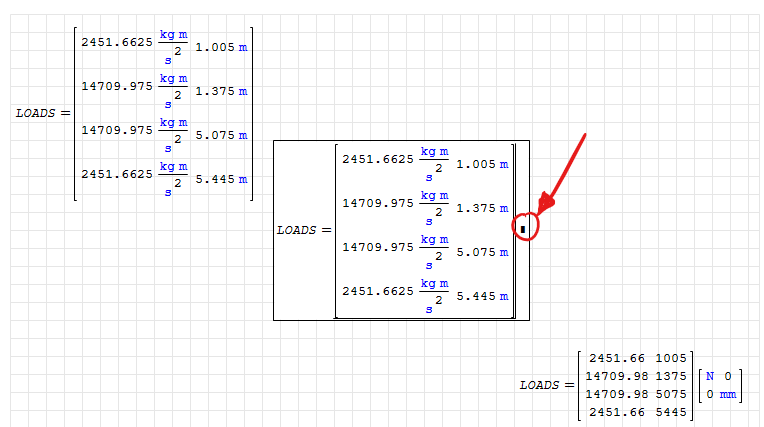

Not sure if I understood but you could show whatever unit is suitable (and consistent) by changing the unit of measure in the displayed results.
Same you would do with a single result, you can change the displayed unit in the black rectangle after results.. only difference from a single formula, is you need to use adiagonal matrix with proper units in proper positions.
At least, this is what I'm often doing to have a clearer view.

It works! Tkank You.
In my case now it looks like:
T := [1 2 3 4 ...] MPa
and that is what I wanted.

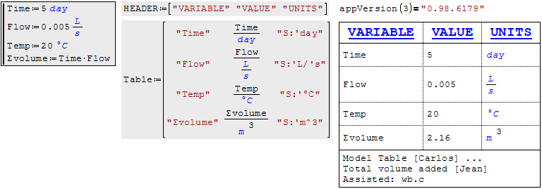

#4 Posted: 12/4/2020 1:57:26 PM
A vector of values can be associated with units.
A data table will have columns units in the header or row wise.
Jadalbert 12/7/2020 8:24:00 AM

#6 Posted: 12/7/2020 9:37:01 AM
... suggestive examples.
Table Scientific.sm (20.56 KiB) downloaded 1207 time(s).
Table Medic Data.sm (17.51 KiB) downloaded 1227 time(s).
Inst_Colebrook Pipe Data.sm (71.4 KiB) downloaded 1228 time(s).
