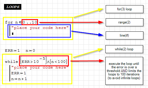

#2 Опубликовано: 14.05.2014 12:29:50
Hello cube, what's exactly the point?
To build a loop use a for or a while statement (something like in the attachment).

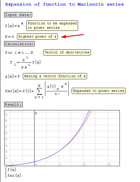

#4 Опубликовано: 21.05.2014 07:46:21
Open Help->Examples and choose "Expansion of function to Maclaurin series", than open it. You can then choose the function as well as the highest power of x.

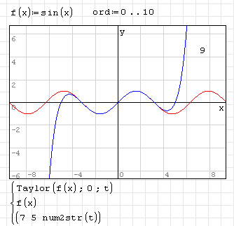

#5 Опубликовано: 21.05.2014 17:53:45
1 353 сообщений из 2 264 понравились пользователям.
Here is an example which uses the Taylor function of the Nonlinear Solvers plugin and animates approximations of inreasing order.
