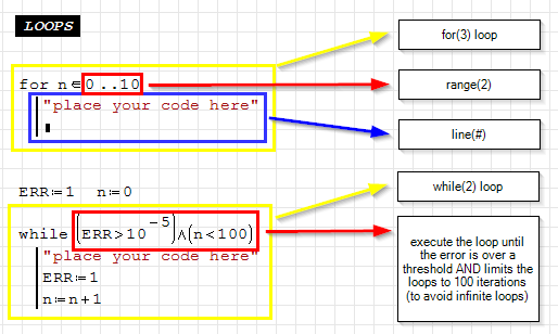

Hello cube, what's exactly the point?
To build a loop use a for or a while statement (something like in the attachment).

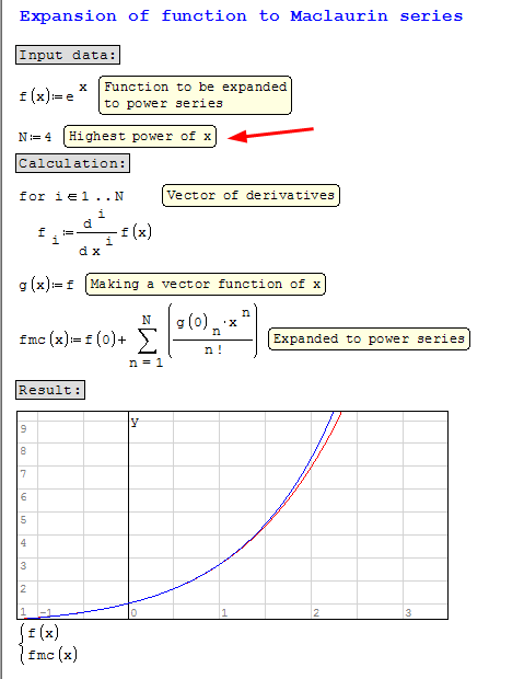

Open Help->Examples and choose "Expansion of function to Maclaurin series", than open it. You can then choose the function as well as the highest power of x.

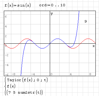

Here is an example which uses the Taylor function of the Nonlinear Solvers plugin and animates approximations of inreasing order.
