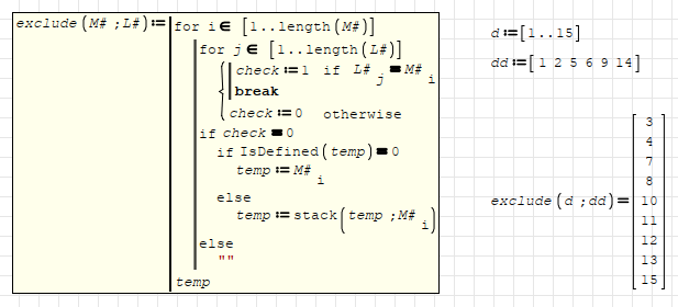

In addition to sergio's answer, you can use an custom exclude function.
It will remove substances of a L# list from master M# list.
exclude.sm (5,92 КиБ) скачан 1201 раз(а).
