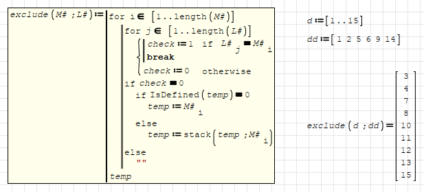

#6 Posted: 1/14/2022 3:06:20 PM
599 likes in 1,380 posts.
In addition to sergio's answer, you can use an custom exclude function.
It will remove substances of a L# list from master M# list.
exclude.sm (5.92 KiB) downloaded 1170 time(s).
