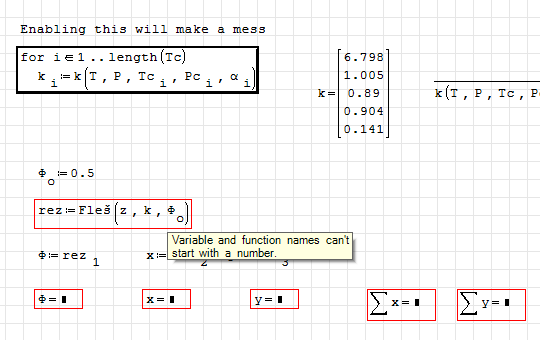

It seems that "i" still causes some headaches. I used a part of one of my standard files and get this rather strange error message
See please the attached file. I have no idea why the famous "i" variable made a mess here

#8 Опубликовано: 17.10.2016 22:17:40
It does not make mess 5346.

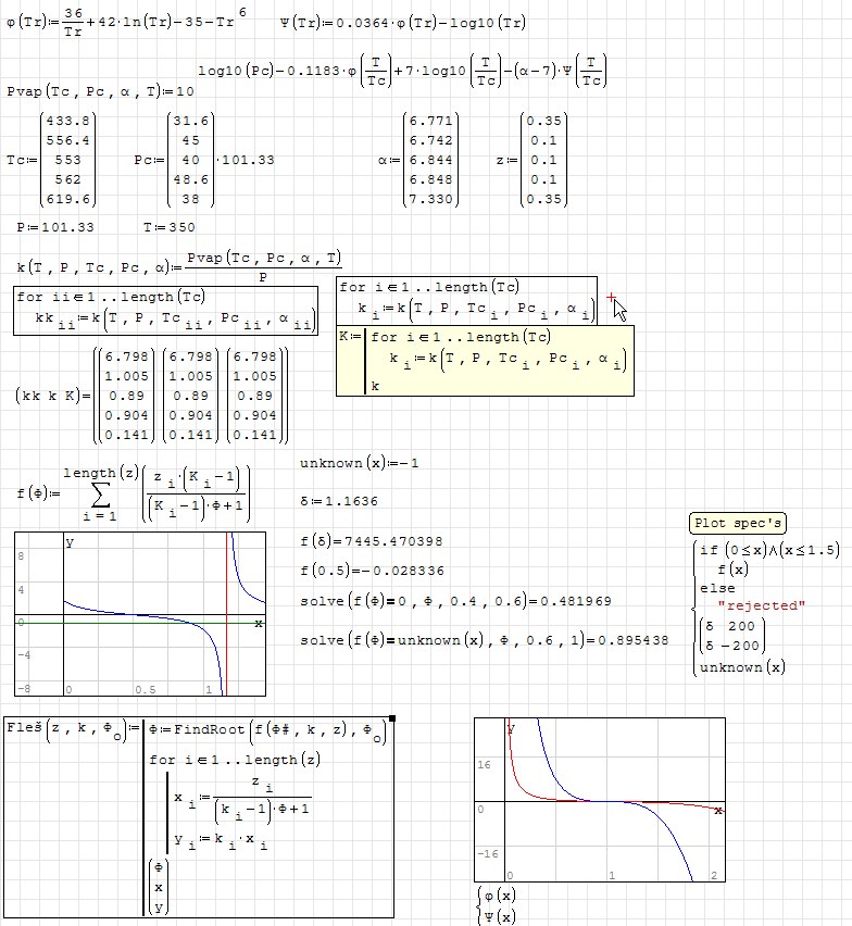

FindRoots [Φ.o] looks under defined wrt Maxima that needs a function
whereas it is not a "root". A "root" crosses the X axis. Φ.o can be
anything in the Catesian plane. You can solve point by point but
NOT on a range. Mathcad 11 would not do either. You are in fact,
in other words, "inversing a function". The Mathcad way is the
"seeded root scanner" over a prescribed discrete range ...
as fast as a lighting strike !!!
Cheers Radovan: Jean

#10 Опубликовано: 18.10.2016 03:53:50
Thank you Jean for your analysis, but I think that here is again introduced some glitch regarding variable i and for loops. I can not figure out what actually happen here, but I could see that there is something that causes that strange error message. Somehow, in the summation instead of variable "i", you get the actual value of i (I do not know why) and it complains because variable can not start with number.

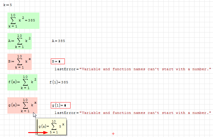

#11 Опубликовано: 18.10.2016 07:27:20
It is not about i, there is a bug in preprocessing wrt the iterator argument of sum() when unknowns are involved in other arguments on definitions; the iterator name is replaced with a value, then when sum tries to evaluate the name is lost.
iterator arg.sm (7,93 КиБ) скачан 1716 раз(а).

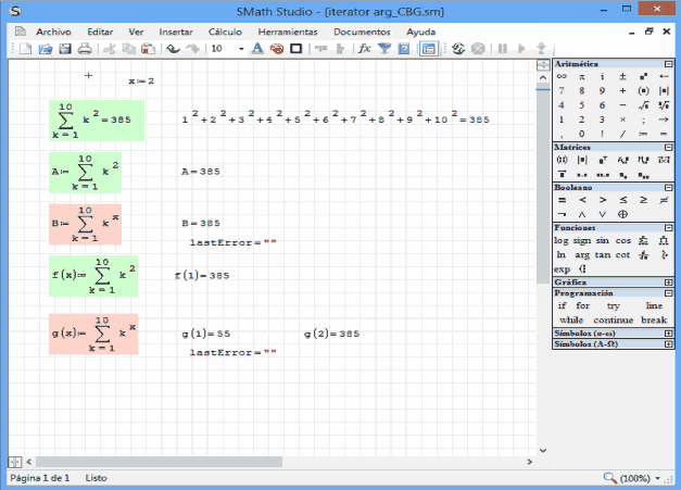

#13 Опубликовано: 18.10.2016 17:30:38
CBG
CBG
Must be not define the variable k, which must be defined is the variable x, because apparently, the sum function does not accept symbolic evaluation
Carlos
iterator arg_CBG.sm (8,35 КиБ) скачан 1683 раз(а).
