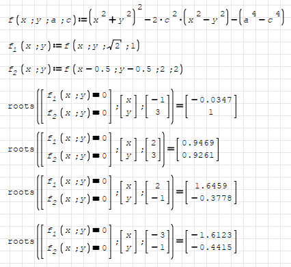

I cannot use the roots function and must use one old good simple method by Newton.
What can you say about it?
Newton-Eng.docx (1,07 МиБ) скачан 969 раз(а).

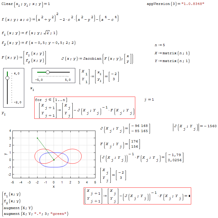

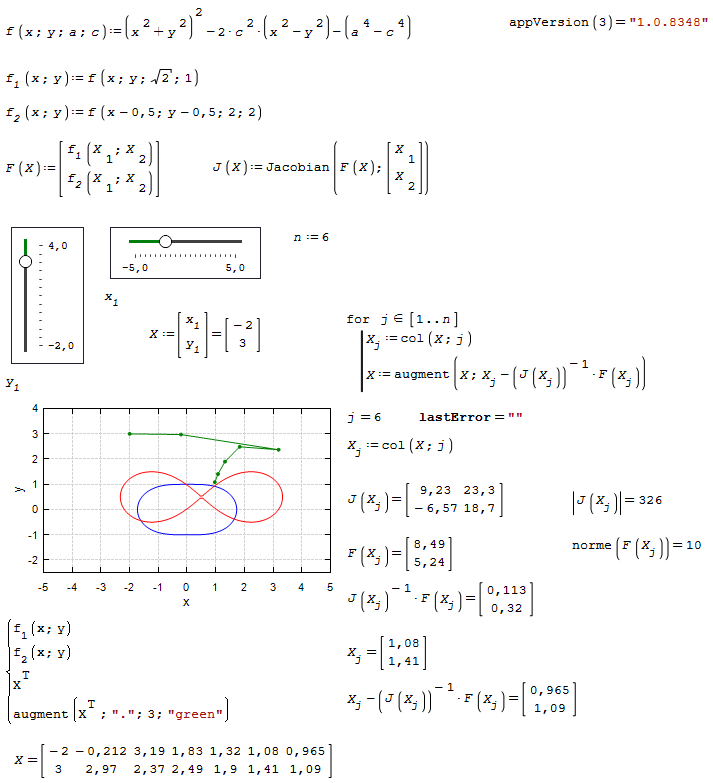

I had problems when reproducing your 2D version. Depending on initial guess I got errors "requested matrix element does not exist". The situation seemed to improve a little by pre-allocating the vectors X and Y yet it didn't become really robust.
So instead of assigning to j+1 elements I used augment() to add new points to the iteration history.
This is the original version:
Newton2D.sm (21,4 КиБ) скачан 1518 раз(а).
And this is the modified version.
Newton2Da.sm (19,03 КиБ) скачан 1641 раз(а).

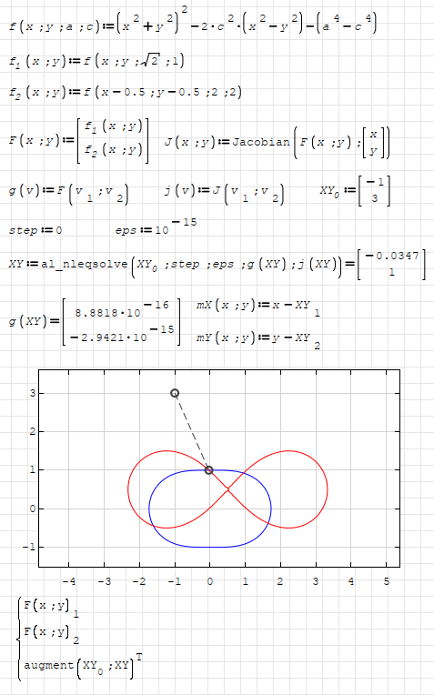

Tried to solve your functions with al_nleqsolve().
Newton.sm (13,85 КиБ) скачан 1558 раз(а).

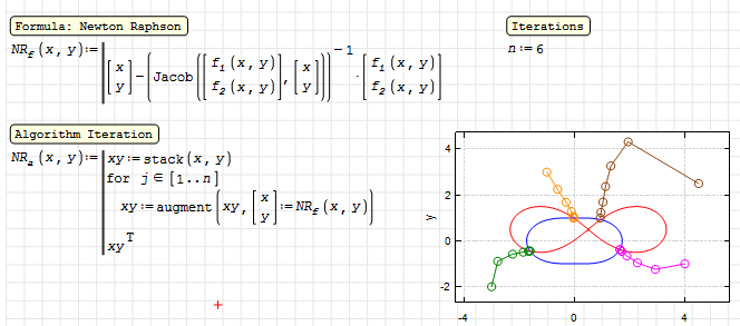

Another way, keeping the mathematical formulation and the iteration algorithm separate. As here.
Newton2Da.sm (13,34 КиБ) скачан 1684 раз(а).

#7 Опубликовано: 10.04.2023 16:21:38
599 сообщений из 1 380 понравились пользователям.
Actually, you can.
#8 Опубликовано: 10.04.2023 20:29:31
An old vintage in Smath ... two examples.
Take care Valery ... Jean.
Solve_roost f1(x,y). f2(x,y).sm (27,42 КиБ) скачан 1633 раз(а).
