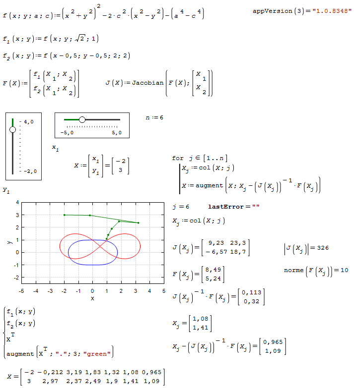

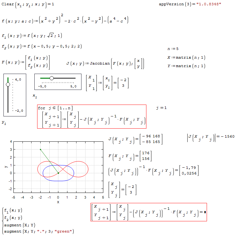

I had problems when reproducing your 2D version. Depending on initial guess I got errors "requested matrix element does not exist". The situation seemed to improve a little by pre-allocating the vectors X and Y yet it didn't become really robust.
So instead of assigning to j+1 elements I used augment() to add new points to the iteration history.
This is the original version:
Newton2D.sm (21.4 KiB) downloaded 1557 time(s).
And this is the modified version.
Newton2Da.sm (19.03 KiB) downloaded 1679 time(s).

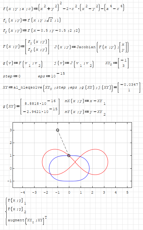

Tried to solve your functions with al_nleqsolve().
Newton.sm (13.85 KiB) downloaded 1596 time(s).

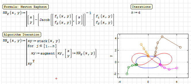

Another way, keeping the mathematical formulation and the iteration algorithm separate. As here.
Newton2Da.sm (13.34 KiB) downloaded 1724 time(s).

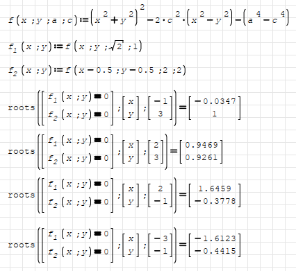

I cannot use the roots function
Actually, you can.
