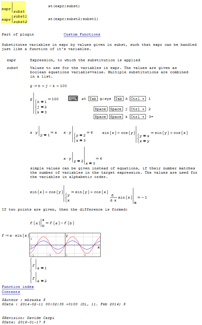

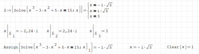

Handbook page for at() and Solve(). at() is a convenient alternative for Assign(), which creates assignments based on equations (as returned by Solve, ODE2 or Fit())

_Solve.sm (33,17 КиБ) скачан 1360 раз(а).
![2023-06-07 20_12_17-SMath Solver - [_Solve.sm_].png](/ru-RU/files/Download/TsxkoZ/2023-06-07-20_12_17-SMath-Solver---[_Solve.sm_].png)
