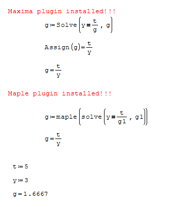

Suppose I have the equation: y = t/g I want to solve for g. What is the correct procedure? I think I have to use symb and a right arrow in there somewhere but I don't know how.

Take a look please at the Maxima and Maple plugins, SMath Wiki, SMath Studio Handbook by Martin Kraska etc.

Great! That seems to be just what I need. Where can I get those plugins?

Well I found the plugins folder and figured that I had to have dll for this maple functions to work. I found the dll's put them in the plugins folder but when I tried to open Smath I got errors about these dll's So I would guess that Smath Studio is just not ready for Prime Time. Besides This whole plugin thing stinks of Linux to me. It must have been just ported to Windows.

You can get plugins from the Extension Manager ( Tools > Plugins > click on "Local Storage" > "Online Gallery" )
Plugins are downloaded and stored in your %APPDAT%\SMath\Extensions directory (the Plugins folder in the program directory is only for built-in plugins)
Be careful in the description of plugins; if are for 32bit systems and you have a 64bit system you may need to use a modified version of SMath.
