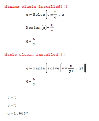

Suppose I have the equation: y = t/g I want to solve for g. What is the correct procedure? I think I have to use symb and a right arrow in there somewhere but I don't know how.

Take a look please at the Maxima and Maple plugins, SMath Wiki, SMath Studio Handbook by Martin Kraska etc.

#5 Posted: 4/23/2014 4:00:27 AM
1,441 likes in 2,932 posts.
You can get plugins from the Extension Manager ( Tools > Plugins > click on "Local Storage" > "Online Gallery" )
Plugins are downloaded and stored in your %APPDAT%\SMath\Extensions directory (the Plugins folder in the program directory is only for built-in plugins)
Be careful in the description of plugins; if are for 32bit systems and you have a 64bit system you may need to use a modified version of SMath.
