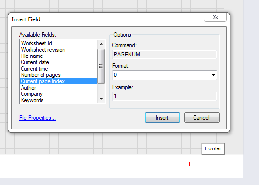

Is there a way of changing or updating a "field"? In my case, I want SMATH page number (PageNum) to start on page 3 as I have a document cover sheet for pages 1 and 2.

That is the problem. I cannot adjust the [PAGENUM] field in the footer

Currently it is not possible. Will implement it soon.

There is a simple solution; In your text field, simply type 「page \[PAGENUM[2]]\ of \[COUNT[2]]\」 to get --> 「page 3 of 3」.
That is: 「\[PAGENUM[n]]\」 where 「n」 = The page number of the page BEFORE your 'first' Smath Page.

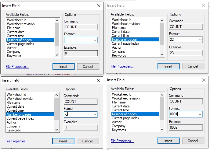

    As it turns out, you don't need to do anything crazy to define an offset for the [COUNT] and [PAGENUM] Fields!
    After trial and error, I finally discovered you can define your first page number within the INSERT FIELD dialog box (by just using your keyboard, you need not use the dropdown). All you need to do is type in a number into the "Format:" and the "Example:" will show you a preview of the first page:
    The interesting thing is that, unlike my previous post, negative numbers ARE supported for [COUNT] and [PAGENUM] Fields! As long as you utilize the [Insert Field] dialog box, negative numbers can be used.
