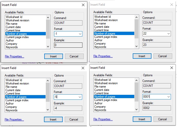

    #12 Опубликовано: 02.12.2022 19:19:06
    ⚜ Kenny Lemens, P.E. ᵂᴵ
    85 сообщений из 179 понравились пользователям.
    Greetings,
    As it turns out, you don't need to do anything crazy to define an offset for the [COUNT] and [PAGENUM] Fields!
    That is the problem. I cannot adjust the [PAGENUM] field in the footer
    After trial and error, I finally discovered you can define your first page number within the INSERT FIELD dialog box (by just using your keyboard, you need not use the dropdown). All you need to do is type in a number into the "Format:" and the "Example:" will show you a preview of the first page:
    The interesting thing is that, unlike my previous post, negative numbers ARE supported for [COUNT] and [PAGENUM] Fields! As long as you utilize the [Insert Field] dialog box, negative numbers can be used.
    -Kenny Lemens, P.E. ᵂᴵ
    Mark R Harris 02.12.2022 22:38:00, sergio 03.12.2022 05:45:00, NDTM Amarasekera 05.12.2022 00:41:00
