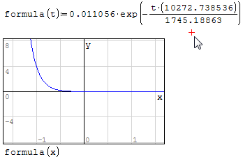

#5 Опубликовано: 25.04.2019 11:02:17
Have you got the same ? easy to sanity check.
