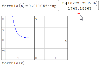

#5 Posted: 4/25/2019 11:02:17 AM
Have you got the same ? easy to sanity check.
