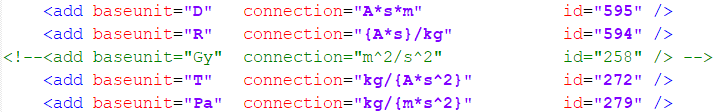

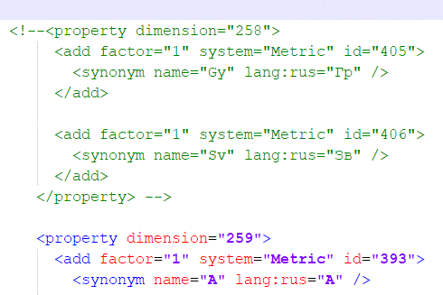

Hi. This is a workaround. Edit the file Units.xml under the SMath/entries/ folder, disabling the entries for the unit Gy:
Then you can get, for example, the enthalpy from Coolprops plugin in J/kg by default:
