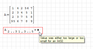

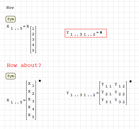

This is very common in other math packages - to extract a matrix from a matrix by having vector indexes. See the picture,
it is clear what we want, but there is an error message. Of course, we can do this by using submatrix(), augment(), stack() function, or by for loop - but it can be sometimes a night mare.

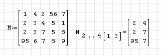

something like this?
Yes, that would be something like vector valued indices in matlab. I support this proposal.
el_plus.sm (19,73 КиБ) скачан 1757 раз(а).
Just like that, very nice Davide
Yes, that would be something like vector valued indices in matlab. I support this proposal....
Exactly Martin, not just in Matlab but just in many other software where this kind of vector valued indices is a rather common (and an elegant) feature.
WroteImplemented (will be available in new build).

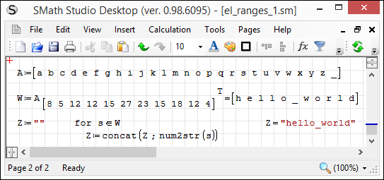

Great. I assume that the feature isn't limited to range()-generated index vectors but can use arbitrary integer vectors.
Might be useful to have some shorthand for using all elements in a given dimension, perhaps an empty placeholder or "all" would do.
This would make the examples even more compact without adding problems for the reader.

I hope I made my point. The primer goal is to define a symbolic vector or matrix by this shorthand notation

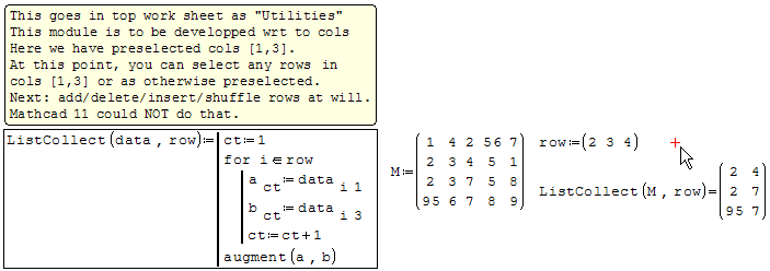

If you think others do something useful: YES, but useless for
practical Engineering works involving specific search in matrix
unless the software has been designed for.
When working with matrices [Smath, Mathcad ...] you need a
"Matrix Treasury" of utilities. You will have more than expected
in the attached document.
Thanks Radovan, most interesting subject.
Utilities Matrix RemToDo [select row_col].sm (5,65 КиБ) скачан 1421 раз(а).

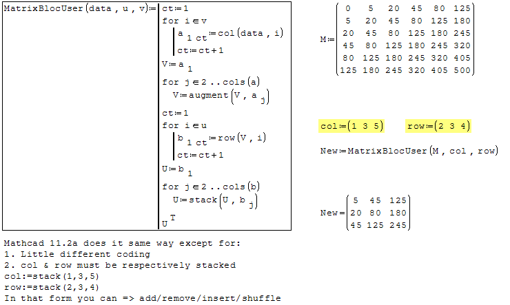

does not work. What I need is a function, and designed as such
fully flexible rather than a local result. There is a bit of story
behind "MatrixBlocUser". Mathcad 11.2a [2003] came with the Excel
read function ++++, how many have used/exchanged work in the forum ?
NONE !!! except during the stage of designing DAEP, the collab had
to read "SunSpot" from his own Excel file.
The 3 functions [matrix utilities] have been vital to me, let's see:
The Project Team constructs the pipe data ... so many cols wide, so
many rows long. The piping designer needs certain cols by the rows
of pipe sizes wrt the project. The purchasing department needs other
set of columns, the transport trucker other set of cols ...
and Jean [the Instrument man] needs his own set of cols/rows.
So, everybody is happy with the "MatrixBlocUser".
Utilities Matrix RemToDo [select row_col].sm (24,72 КиБ) скачан 1416 раз(а).

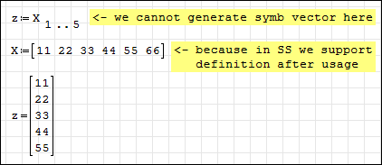

Wrotewe cannot generate symb vector here
because in SS we support definition after usage
Hm. I just don't seem to understand...
Why isn't possible to re-interpret el(X,range(1,5)) as mat(el(X,1),el(X,2),el(X,3),el(X,4),el(X,5),5,1)? Aren't these expressions equivalent in any case? If value of X is undefined, this doesn't seem to change the situation...
WroteWrotewe cannot generate symb vector here
Thank you for your comment Mike. I did not understand this as well but had to accept what Andrey explained about it for granted.
BTW, this gave me headache many times when I had to define a symbolic vector, matrix (having the elements in standard notation like mat(el(X,1),el(X,2),el(X,3)...) with more than few variables. I hoped this might be the most simplest way.
There must be something simpler than this, or I just forgot how to perform this in as simpler way
Symbolic vector matrix

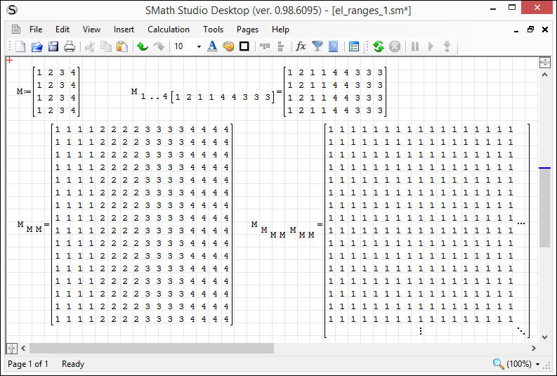

WroteYou can test new functionality in SMath Studio in the Cloud.
Here is my sandbox to play: http://smath.info/cloud/worksheet/gYFgZBnd.
Best regards, Andrey Ivashov.

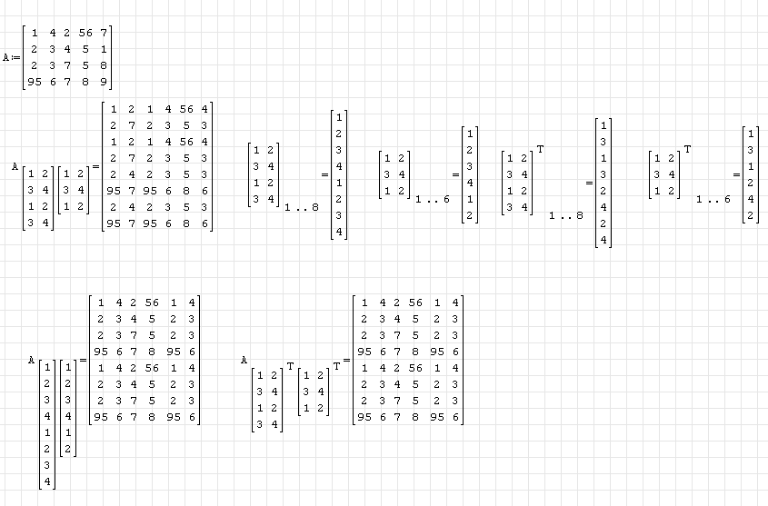

The sandbox example shows the use of matrices as indices. The question is, how the rules for such indices are.
A straightforward rule would be that whatever you provide as index structure, it is accessed by linear indexing from 1..length() of the index structure.
The following example shows that the actual behaviour is different. The index matrices are indexed column-wise and not row-wise as the usual linear indexing works.
I propose to change this in order to be consistent with general linear indexing.
Example (cloud)
