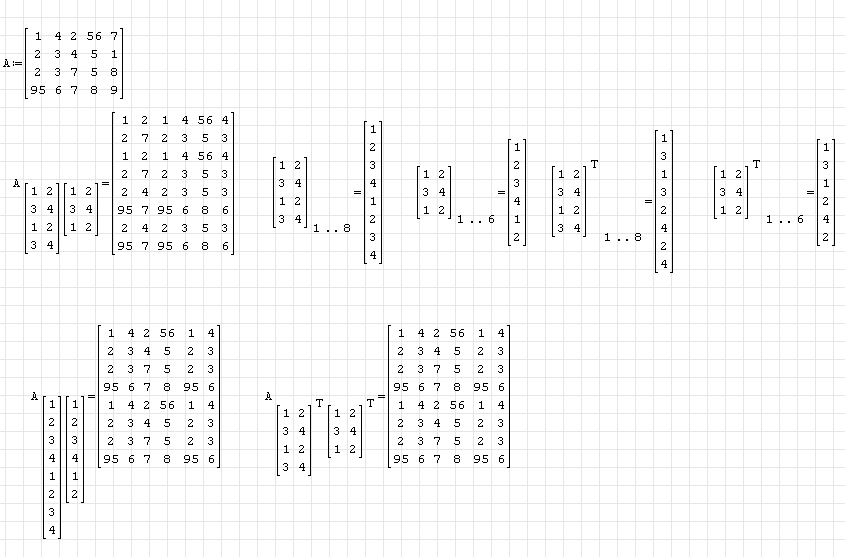

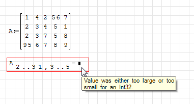

I do not believe such a feature would ever exits in SMath (it does not exit in Mathcad, Prime etc. as well) but I just had an urge to mention this (again). Actually, after such a long time I had to believe it is impossible to just make it real because it would have been made already. For example, if any of you have some time, just read the post from a Guest about 6 years ago (here)

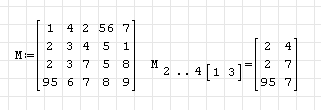

This is very common in other math packages - to extract a matrix from a matrix by having vector indexes. See the picture,
it is clear what we want, but there is an error message. Of course, we can do this by using submatrix(), augment(), stack() function, or by for loop - but it can be sometimes a night mare.
Ra

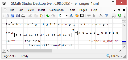

#2 Posted: 9/8/2016 7:45:48 AM
1,443 likes in 2,936 posts.
Very nice Radovan
something like this?
el_plus.sm (19.73 KiB) downloaded 1758 time(s).
Serg 9/8/2016 8:05:00 AM, Radovan Omorjan 9/8/2016 9:45:00 AM, Martin Kraska 9/8/2016 9:27:00 AM
#3 Posted: 9/8/2016 9:38:41 AM
1,361 likes in 2,275 posts.
Yes, that would be something like vector valued indices in matlab. I support this proposal.
This would be the little brother of Mathcad range variables (implicit iteration in assignments over vector valued indices, currently this requires for loops)
The availability of range variables mitigates the need for el_plus in Mathcad, because you can define your index vectors r and c, create range variables
i=1...length(r), j=1..length(c)
Result[(i,j) = M[(r[i,c[j)
Radovan Omorjan 9/8/2016 10:22:00 AM
#4 Posted: 9/8/2016 10:21:03 AM
Very nice Radovan
Just like that, very nice Davide . If you could make operators from these functions like el(M, that would be amazing
#5 Posted: 9/8/2016 10:26:13 AM
2,343 likes in 4,056 posts.
Implemented (will be available in new build).
Thank you, Radovan.

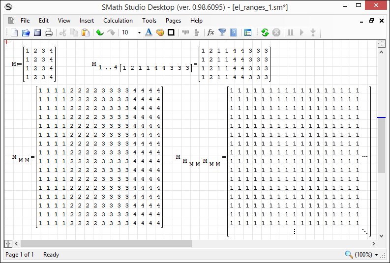

#9 Posted: 9/8/2016 12:00:02 PM
I assume that the feature isn't limited to range()-generated index vectors but can use arbitrary integer vectors.
I did afraid someone may ask this question. Yes, I didn't introduce any limits there, you can even use matrices:
Not sure what it means, but it works

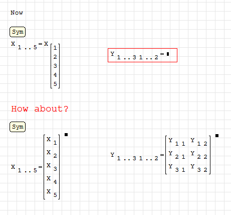

This would be very appreciated and would give some new opportunities (and unexpected behavior).
Moreover, my greedy mind does not let me go and bothers me with vector (matrix) indices for undefined variables. Here is the picture
I hope I made my point. The primer goal is to define a symbolic vector or matrix by this shorthand notation
Ra

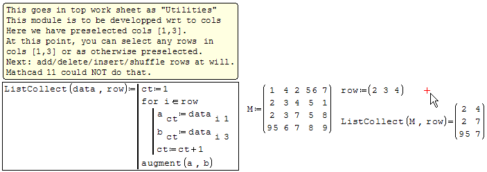

Sorry for "Mathcaders Primes", Mathcad 11 did it simple because
it supported index [indices] as argment. Smath does not.
Though submatrix look alike between Smath/Mathcad, except for
the indexing, they are not the same ...
Explain: In Mathcad, if you want to mirror a matrix [think of
an image], you just need to reverse the cols order. Smath does
not support the reverse cols order.
If you think others do something useful: YES, but useless for
practical Engineering works involving specific search in matrix
unless the software has been designed for.
When working with matrices [Smath, Mathcad ...] you need a
"Matrix Treasury" of utilities. You will have more than expected
in the attached document.
Thanks Radovan, most interesting subject.
Thank you Jean for the comment, and you are very welcome as always.
As Andrey introduced this new feature, you can just use intrinsic SS possibilities rather than writing new functions like your own, or as Davide wrote few ones in the post above, for extracting the values from a matrix in the way you want. I also mentioned, as you did, that this feature do not have neither Mathcad nor Prime(I think).

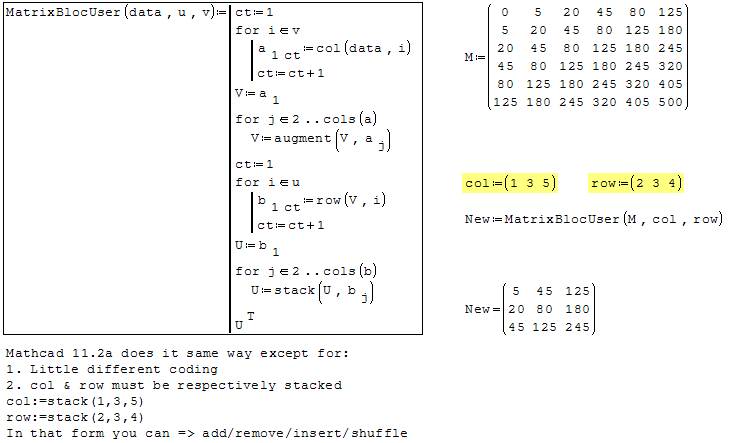

#17 Posted: 9/8/2016 9:30:05 PM
The snipet does it nice, does not work in 5346, and very glad it
does not work. What I need is a function, and designed as such
fully flexible rather than a local result. There is a bit of story
behind "MatrixBlocUser". Mathcad 11.2a [2003] came with the Excel
read function ++++, how many have used/exchanged work in the forum ?
NONE !!! except during the stage of designing DAEP, the collab had
to read "SunSpot" from his own Excel file.
The 3 functions [matrix utilities] have been vital to me, let's see:
The Project Team constructs the pipe data ... so many cols wide, so
many rows long. The piping designer needs certain cols by the rows
of pipe sizes wrt the project. The purchasing department needs other
set of columns, the transport trucker other set of cols ...
and Jean [the Instrument man] needs his own set of cols/rows.
So, everybody is happy with the "MatrixBlocUser".

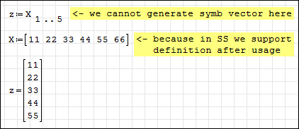

we cannot generate symb vector here
because in SS we support definition after usage
Hm. I just don't seem to understand...
Why isn't possible to re-interpret el(X,range(1,5)) as mat(el(X,1),el(X,2),el(X,3),el(X,4),el(X,5),5,1)? Aren't these expressions equivalent in any case? If value of X is undefined, this doesn't seem to change the situation...

Thank you for your comment Mike. I did not understand this as well but had to accept what Andrey explained about it for granted.
BTW, this gave me headache many times when I had to define a symbolic vector, matrix (having the elements in standard notation like mat(el(X,1),el(X,2),el(X,3)...) with more than few variables. I hoped this might be the most simplest way.
There must be something simpler than this, or I just forgot how to perform this in as simpler way
