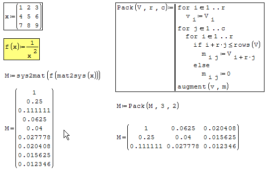

It is by design. Procedure (with line on the right side) should be used instead of simple function.

#42 Опубликовано: 30.03.2016 14:34:59
The problem is that "vectorize" is not passed through with the function definition
It would NOT work in Mathcad 11 either. In your definition, there is nothing
to "vectorise", i.e: NO component wise operation. I'm an adept of designing
what I want in modular ways. After all, that's what Smath is structured for.

#43 Опубликовано: 31.03.2016 11:11:31
Ruben Sidranski
Ruben Sidranski
How did you get the solid vertical line in front of the function definition?
It would NOT work in Mathcad 11 either. In your definition, there is nothing to "vectorise", i.e: NO component wise operation. I'm an adept of designing what I want in modular ways. After all, that's what Smath is structured for.
My Mathcad 14/15 sheets work this way. Your matrix is the programming that goes with the logic. Honestly, these little snippets are golden for me. I usually take longer in my sheets trying to do what comes naturally to you...
#44 Опубликовано: 31.03.2016 11:17:00
Alexander O. Melnik
Alexander O. Melnik
#45 Опубликовано: 31.03.2016 11:36:32
Ruben Sidranski
Ruben Sidranski
Alex,
I tried the programming bar prior to posting my question. Did not work due to two inputs ...
Based on your answer, I just went back, did the programing line and deleted the second variable input ... it worked! DUH for me!
Logic behind using the programming line for it to work??? Would like to document for my notes other than ... it works
