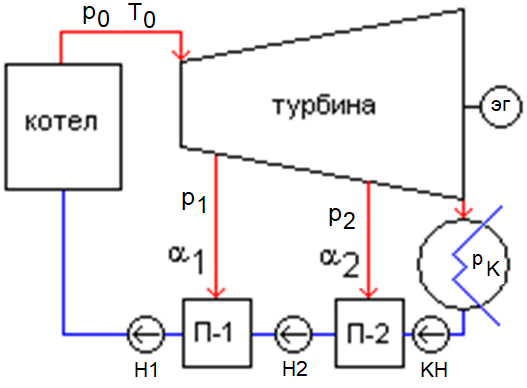

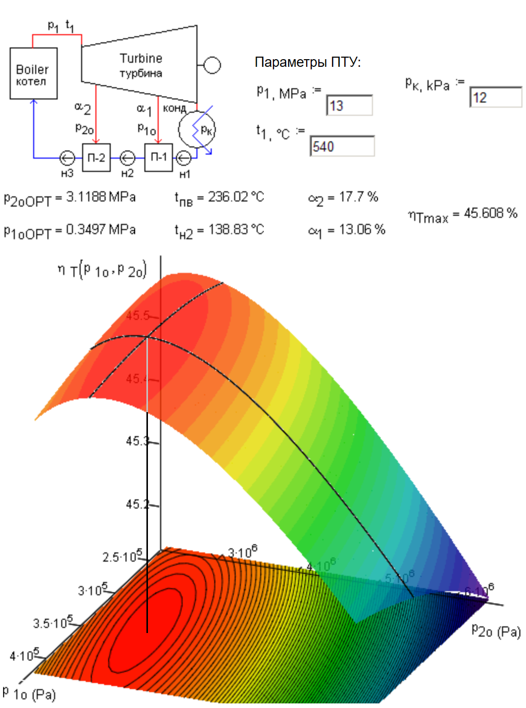

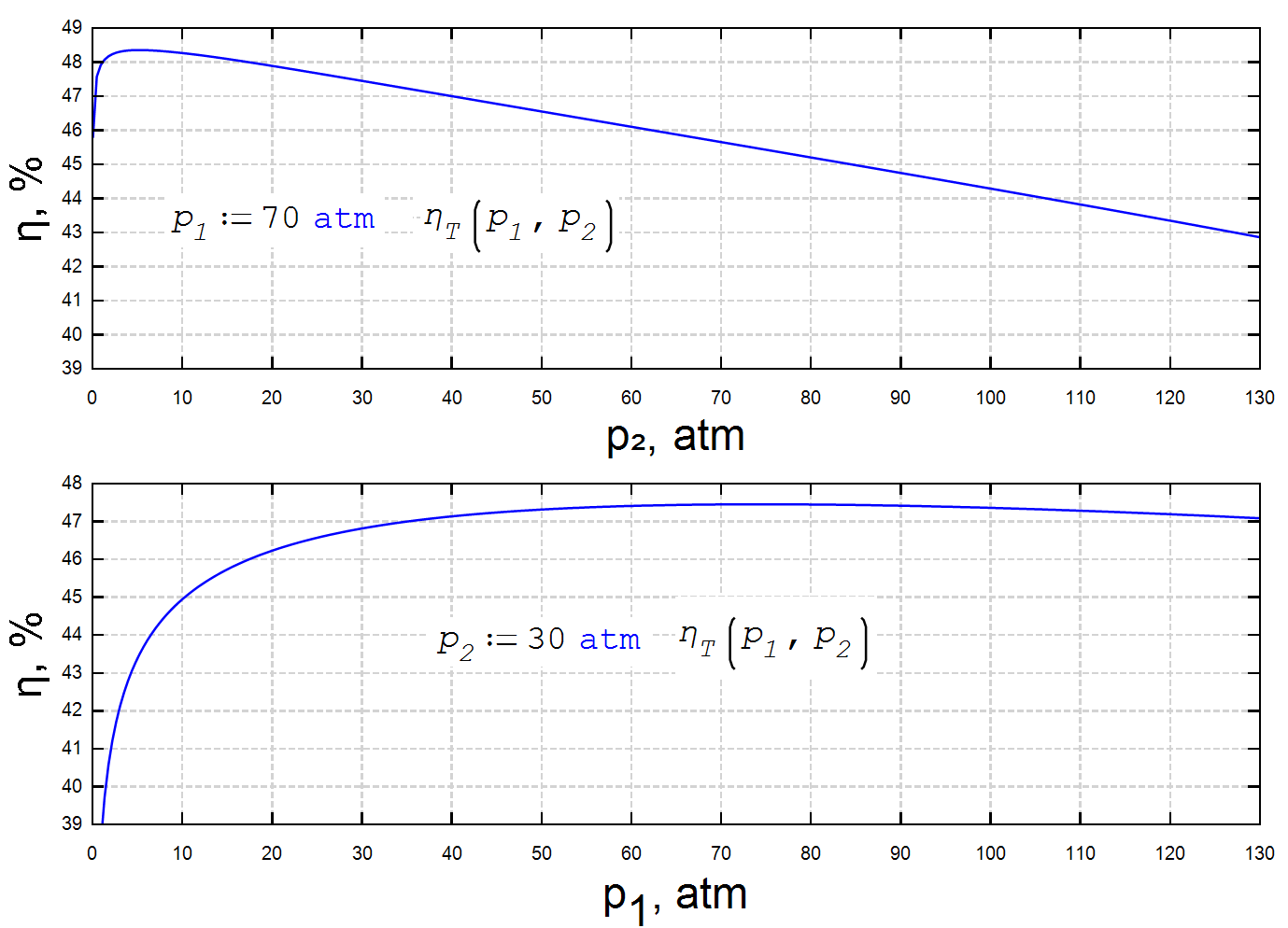

I have f(x, y) - thermal efficiency of a steam turbine with two steam extractions for heating feed water depending on the extraction pressures.
Question.
1. How to find the optimal pressure values at which the efficiency will be maximum?
2. Is it possible to build a surface? For now I have two separate 2D graphics.

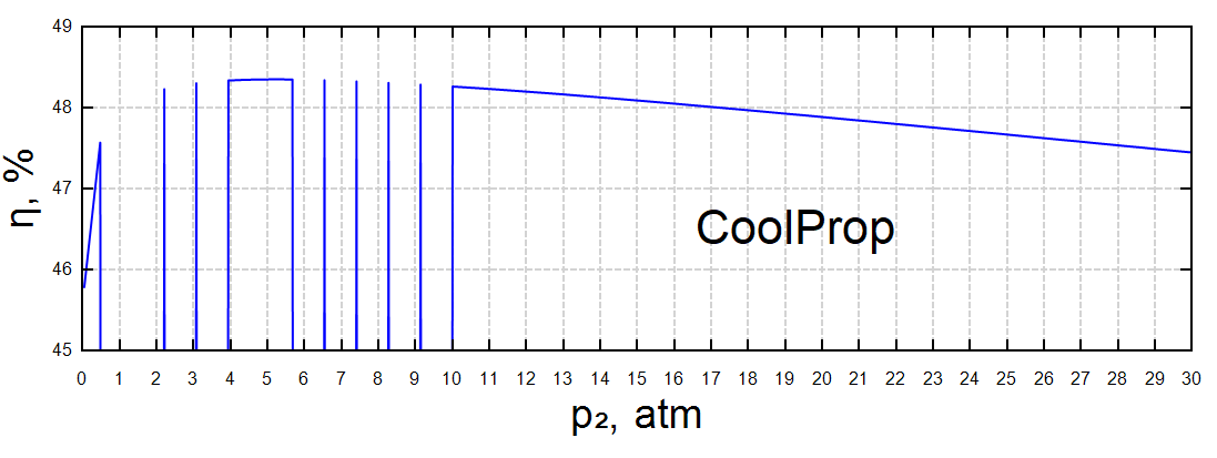

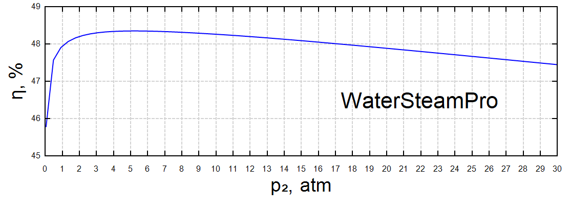

No, you cannot replace WaterSteamPro with Cool Prop for water/steam.
WaterSteamPro is a certified program!
Compare please two plots

Martin (and all), I am waiting for the solution - 3D-plot and optimal values of p1 and p2.

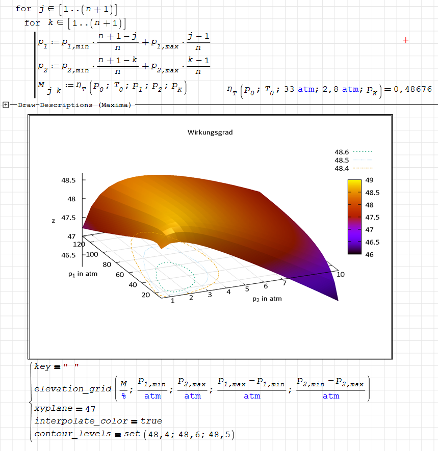

#7 Опубликовано: 08.11.2023 21:11:41
Just the plot, no optimization yet.
2RegP-Ideal-Cool_Prop-95_Kr.sm (300,35 КиБ) скачан 1557 раз(а).
Oscar Campo 08.11.2023 21:22:00, Valery Ochkov 08.11.2023 22:27:00

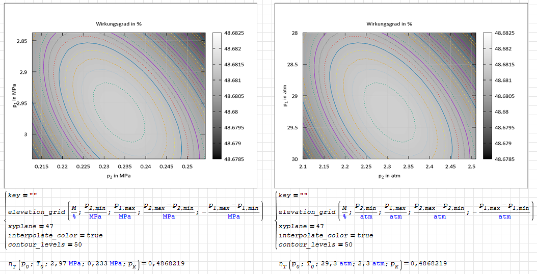

#12 Опубликовано: 12.11.2023 02:37:31
No optimization yet.
For checking
I get slightly different values. Still no automatic optimization because the objective function doesn't translate to Maxima. As a first step I made the function more robust by solving the two equations sequentially instead of simultaneously. In the original version sampling for the plot occasionally failed.
Plot MPa.pdf (219,47 КиБ) скачан 945 раз(а).
2RegP-Ideal-Cool_Prop-95_Kr_detail.sm (157,12 КиБ) скачан 1572 раз(а).
2023-11-11 19_21_55-SMath Solver - [2RegP-Ideal-Cool_Prop-95_Kr_detail.sm_].png
2RegP-Ideal-Cool_Prop-95_Kr_detail.pdf (520,5 КиБ) скачан 903 раз(а).
Valery Ochkov 12.11.2023 02:41:00, Alvaro 12.11.2023 09:04:00

#14 Опубликовано: 12.11.2023 09:07:21
I get slightly different values. ...
Hi. Using the definition for partial derivatives and a pure numerical solver.
2RegP-Ideal-Cool_Prop-95_Kr_detail.sm (162,36 КиБ) скачан 1491 раз(а).
Martin Kraska 12.11.2023 09:10:00, Valery Ochkov 12.11.2023 14:12:00, Oscar Campo 12.11.2023 18:29:00
