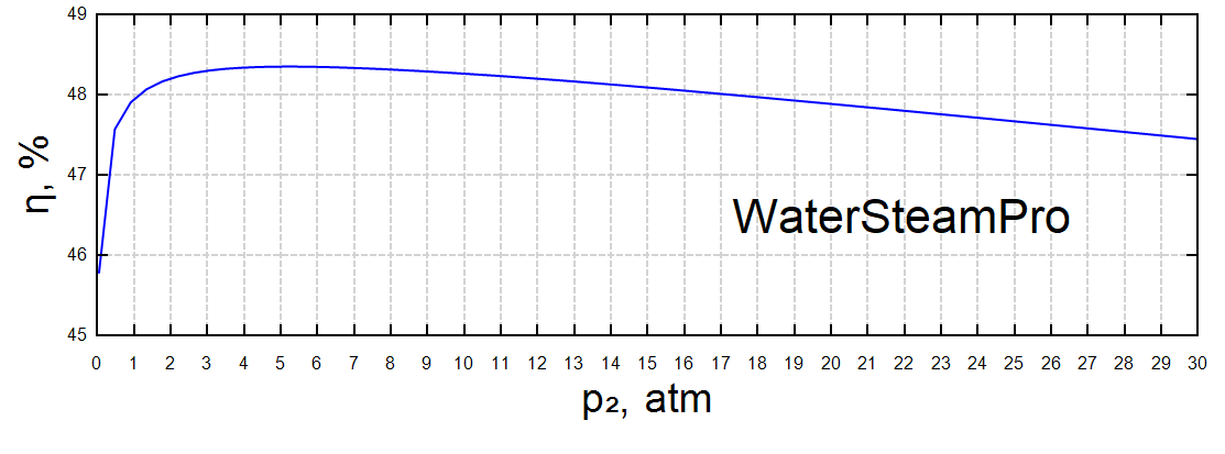

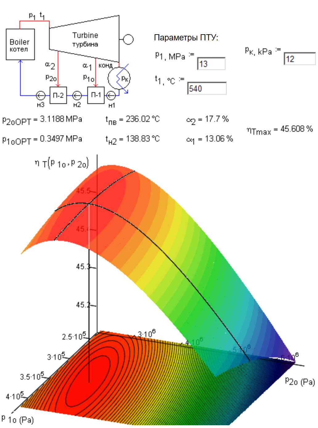

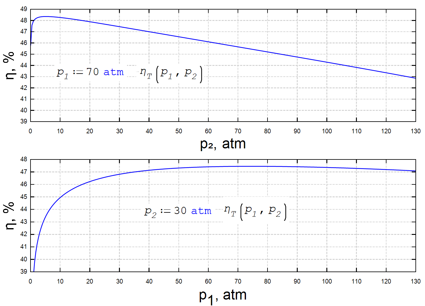

I have f(x, y) - thermal efficiency of a steam turbine with two steam extractions for heating feed water depending on the extraction pressures.
Question.
1. How to find the optimal pressure values at which the efficiency will be maximum?
2. Is it possible to build a surface? For now I have two separate 2D graphics.

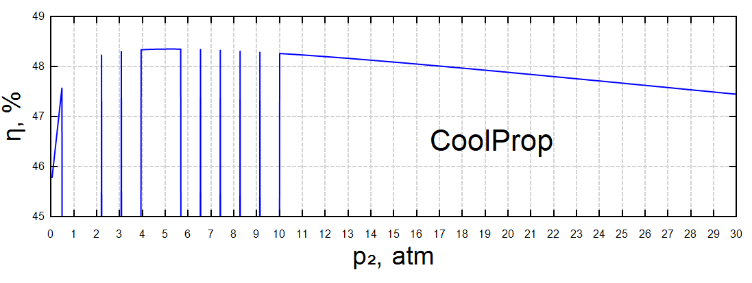

No, you cannot replace WaterSteamPro with Cool Prop for water/steam.
WaterSteamPro is a certified program!
Compare please two plots

OK but I need a file where the wsp calls are replaced by coolprop ones. Even if plotting doesn't work as expected.
See please attach
2RegP-Ideal-Cool_Prop-95.sm (73.63 KiB) downloaded 1352 time(s).
2RegP-Ideal-Cool_Prop-95.pdf (361.44 KiB) downloaded 791 time(s).

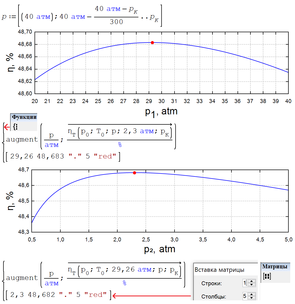

Martin (and all), I am waiting for the solution - 3D-plot and optimal values of p1 and p2.

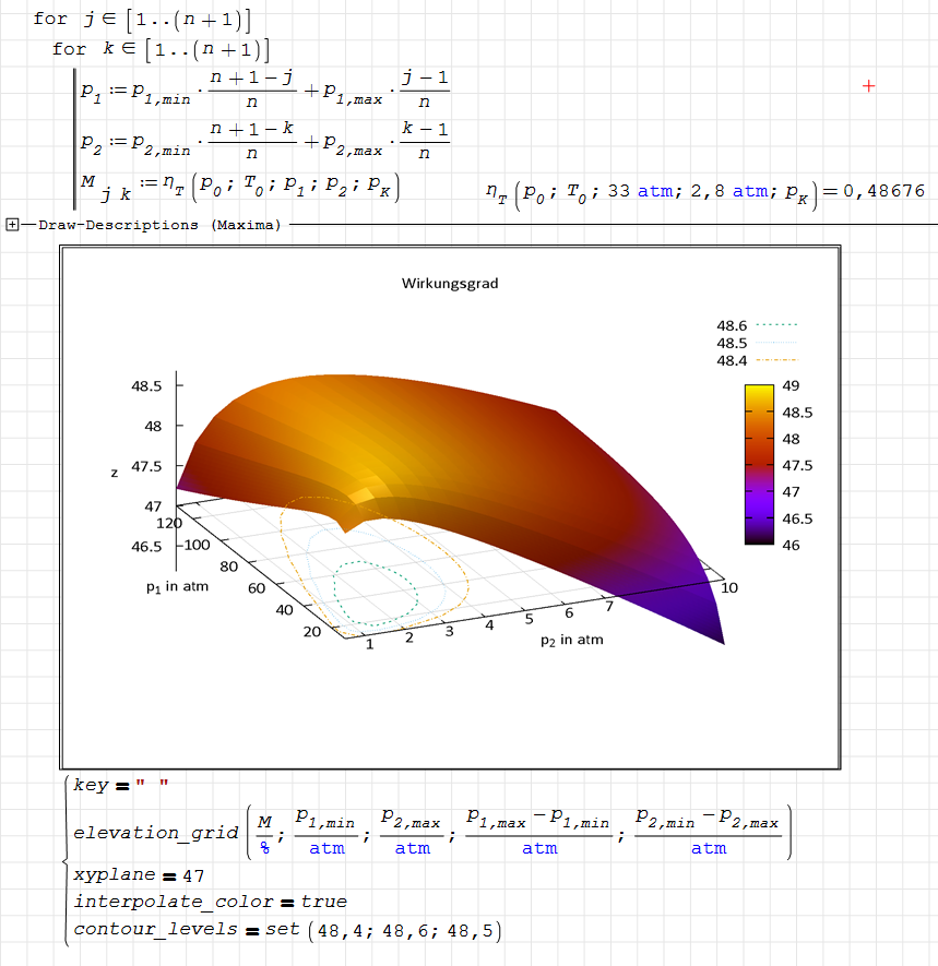

#7 Posted: 11/8/2023 9:11:41 PM
1,355 likes in 2,270 posts.

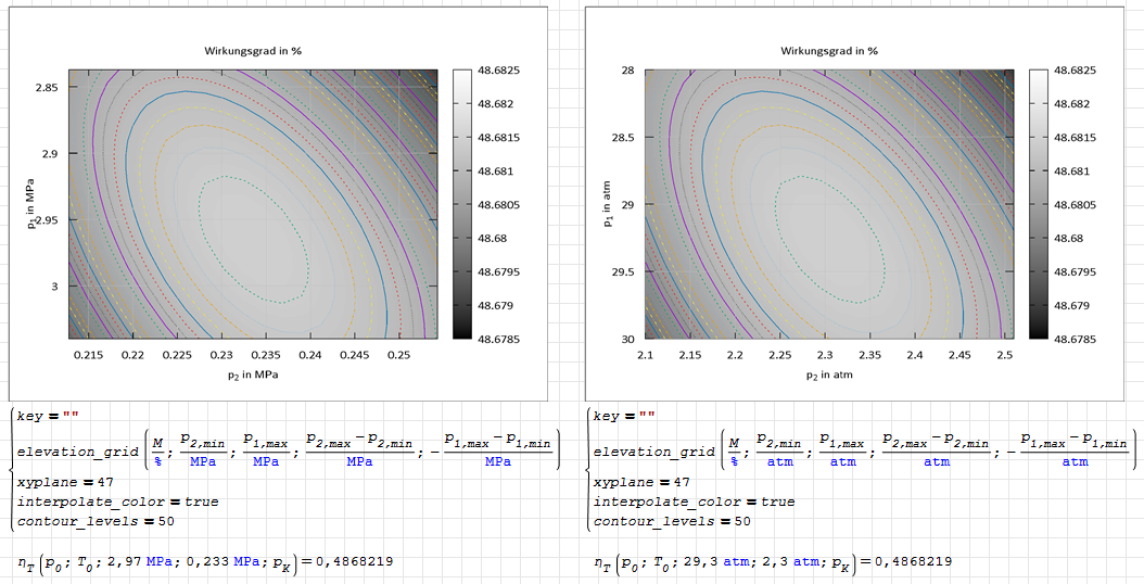

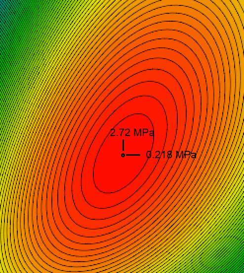

Just the plot, no optimization yet.
2RegP-Ideal-Cool_Prop-95_Kr.sm (300.35 KiB) downloaded 1346 time(s).
Oscar Campo 11/8/2023 9:22:00 PM, Valery Ochkov 11/8/2023 10:27:00 PM

No optimization yet.
For checking

#12 Posted: 11/12/2023 2:37:31 AM
For checking
I get slightly different values. Still no automatic optimization because the objective function doesn't translate to Maxima. As a first step I made the function more robust by solving the two equations sequentially instead of simultaneously. In the original version sampling for the plot occasionally failed.
Plot MPa.pdf (219.47 KiB) downloaded 771 time(s).
2RegP-Ideal-Cool_Prop-95_Kr_detail.sm (157.12 KiB) downloaded 1373 time(s).
2023-11-11 19_21_55-SMath Solver - [2RegP-Ideal-Cool_Prop-95_Kr_detail.sm_].png
2RegP-Ideal-Cool_Prop-95_Kr_detail.pdf (520.5 KiB) downloaded 757 time(s).
Valery Ochkov 11/12/2023 2:41:00 AM, Alvaro 11/12/2023 9:04:00 AM

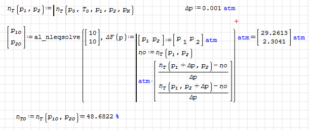

#14 Posted: 11/12/2023 9:07:21 AM
1,123 likes in 1,795 posts.
I get slightly different values. ...
Hi. Using the definition for partial derivatives and a pure numerical solver.
2RegP-Ideal-Cool_Prop-95_Kr_detail.sm (162.36 KiB) downloaded 1296 time(s).
Martin Kraska 11/12/2023 9:10:00 AM, Valery Ochkov 11/12/2023 2:12:00 PM, Oscar Campo 11/12/2023 6:29:00 PM
