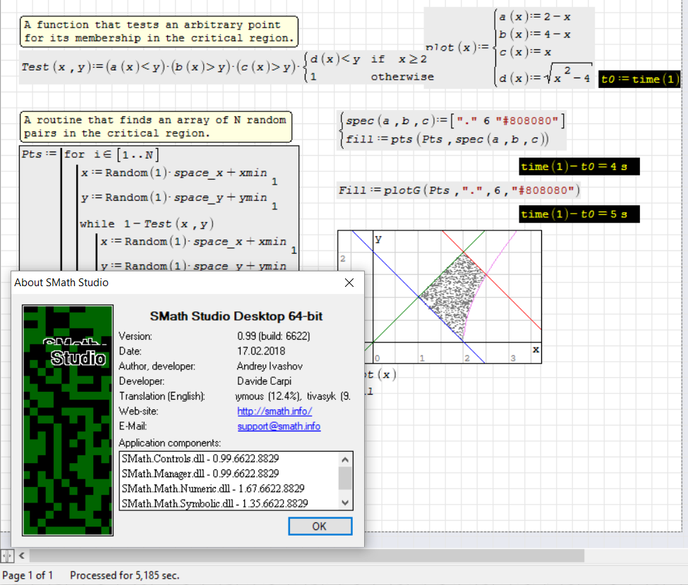

This refactored style is ~ 25 times faster than the very original.
The nested style does not ring a bell about specific use ?

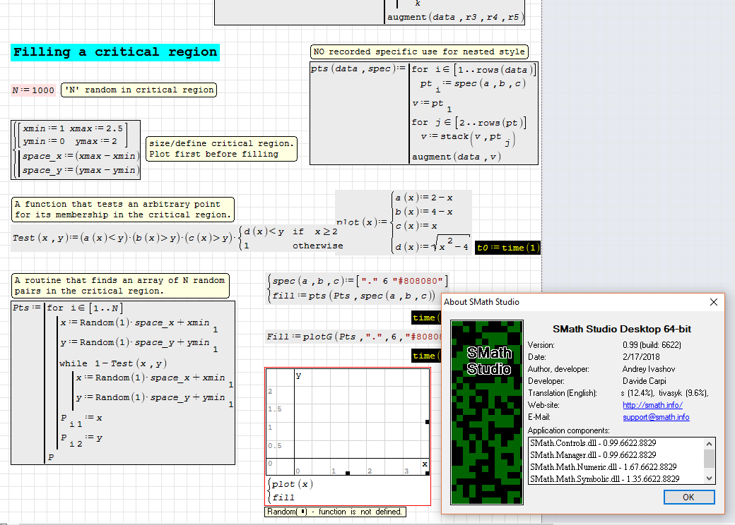

It does not work in 6622.
In Graph: (does not display any graph)
Error: Random()= Function is not defined.
Thanks,
Basile

Hello [USERLINK]Basile[/USERLINK].
It does work on my copy of 0.99.6622:
Tried different locales - everything seems ok.
Random(..) function is from Statistical Tools plug-in. Please check if this plug-in available on your PC.

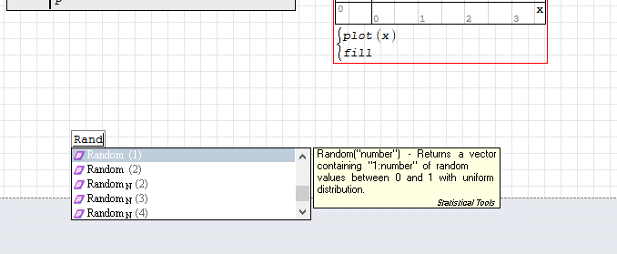

SMath-01.PNGHello Andrey,
Attached please find a print screen.
Am I doing something wreong?
Thank you,
Basile

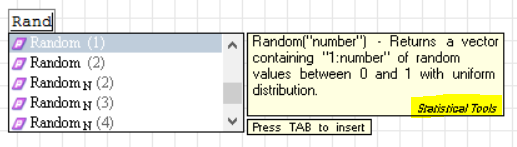

SMath-02.PNGIt looks that it is...
Please could you check what plug-in handles Random function in your case?
Also please try to test Random function... will it work in most usual scenarios on your environment?

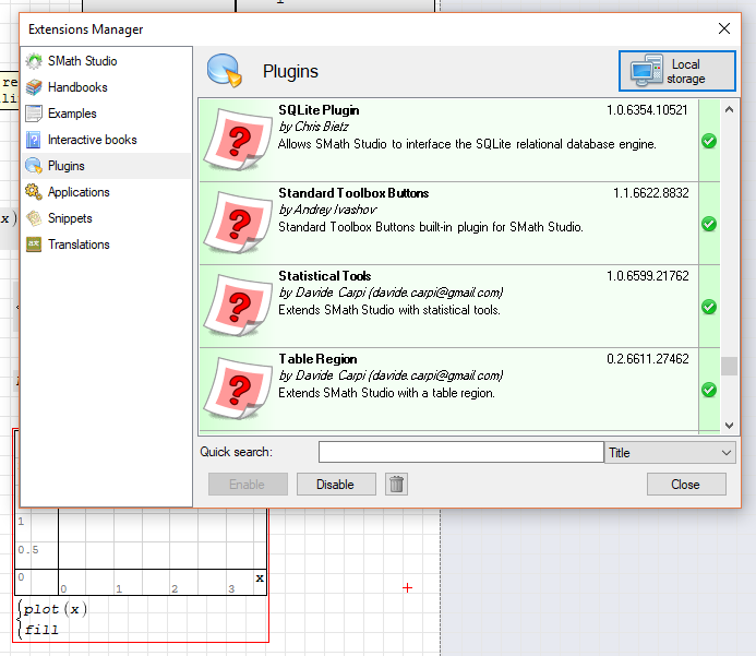

SMath-03.PNGHere it is...
And how do you want me to test the Rand, please?

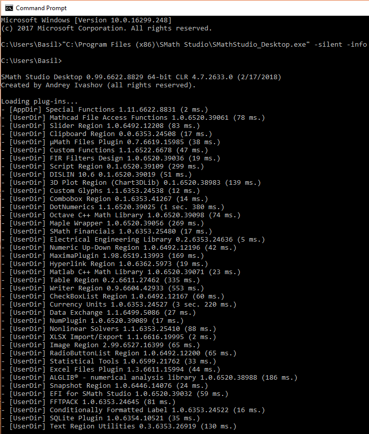

#12 Опубликовано: 19.02.2018 14:46:31
Группа: Super Administrator
Not sure, but may be this is because of sort order of plug-ins or some additional plug-in which breaks the logic...

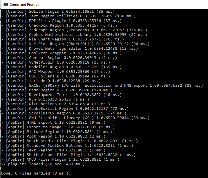

Please could you execute the following in command line? (path to SMathStudio_Desktop.exe may differ on your PC)
"C:\Program Files (x86)\SMath Studio\SMathStudio_Desktop.exe" -silent -info
I would like to see the output of this command in order to try to reproduce this on my environment.
Davide Carpi 19.02.2018 20:37:00
#13 Опубликовано: 19.02.2018 22:09:18
Basile
Basile
8 сообщений из 172 понравились пользователям.
SMath-05.PNGHere it is:
#14 Опубликовано: 19.02.2018 22:11:22
Basile
Basile
#15 Опубликовано: 21.02.2018 03:59:05
Thank you very much! Now I have everything to try reproducing this issue.
