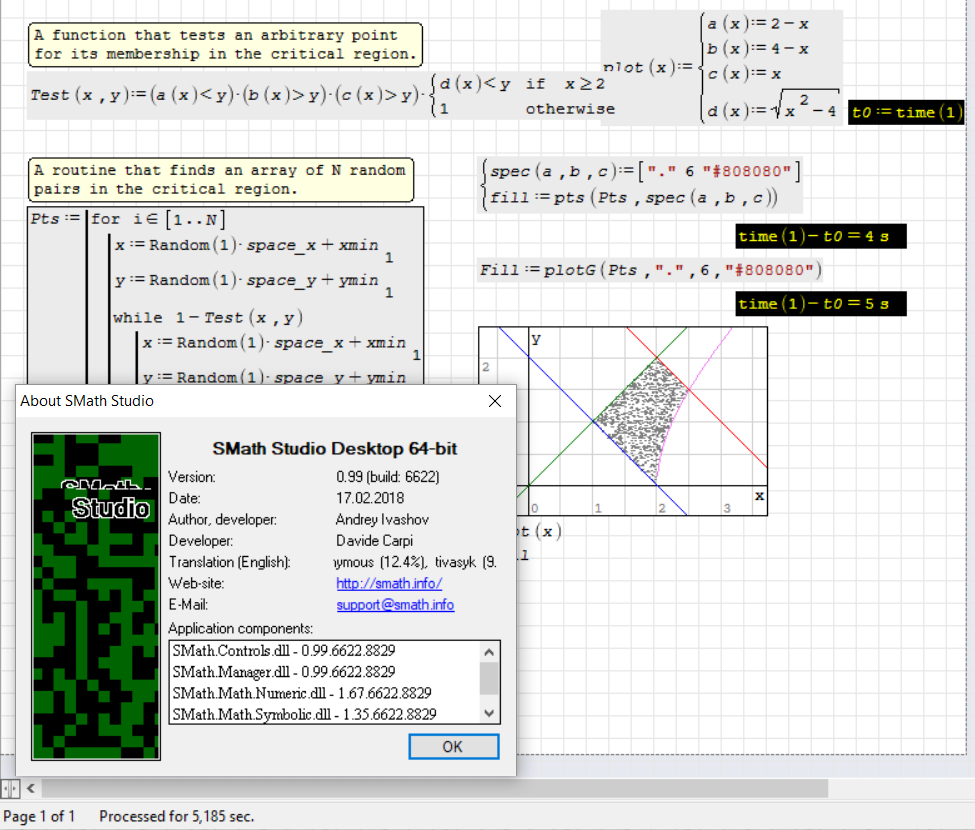

This refactored style is ~ 25 times faster than the very original.
The nested style does not ring a bell about specific use ?
Random_8 Fill Critical Region.sm (17.72 KiB) downloaded 1356 time(s).

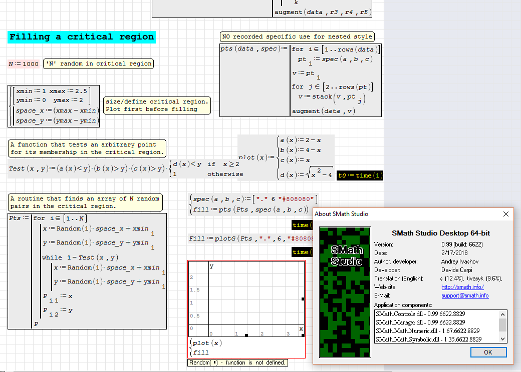

Jean,
It does not work in 6622.
In Graph: (does not display any graph)
Error: Random()= Function is not defined.
Thanks,
Basile
Thanks,
Basile

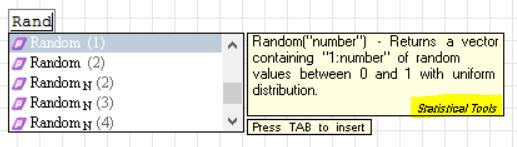

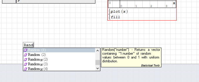

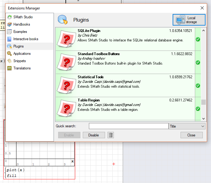

WroteRandom(..) function is from Statistical Tools plug-in. Please check if this plug-in available on your PC.

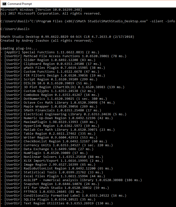

#12 Posted: 2/19/2018 2:46:31 PM

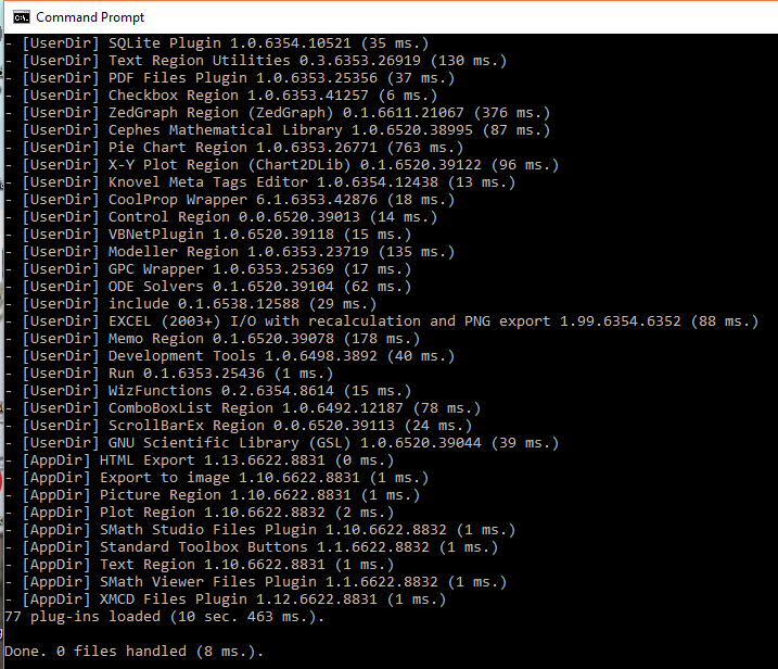

Not sure, but may be this is because of sort order of plug-ins or some additional plug-in which breaks the logic...
Please could you execute the following in command line? (path to SMathStudio_Desktop.exe may differ on your PC)
I would like to see the output of this command in order to try to reproduce this on my environment.
"C:\Program Files (x86)\SMath Studio\SMathStudio_Desktop.exe" -silent -info
Davide Carpi 2/19/2018 8:37:00 PM
#15 Posted: 2/21/2018 3:59:05 AM
Thank you very much! Now I have everything to try reproducing this issue.
