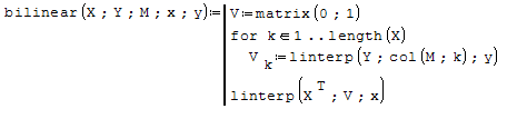

could you please suggest an efficient bilinear interpolation algorithm?
Now I use this rather ugly ang inefficient function, that will take forever (see attachment).
To make this more efficient, I must look for two adjacent columns and two adjacent rows, taking into account possible unsorted input, possibly outside position (extrapolation) and possible perfect match. This will likely be slow, too. Maybe there's any better approach?

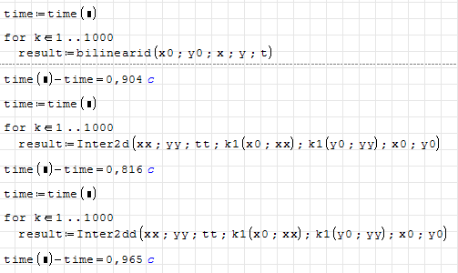

Here is a typical result on my computer (using your sample data). The results are consistently reproducible (±0.010s)
Notably slower is (surprisingly) Inter2dd, while Inter2d is steadily faster (though not that much faster - I suppose that further optimisation could give greater boost) than my variant. I wonder why these two almost identical functions work so differently in terms of performance?
I didn't test for corner cases yet. Also, larger tables should be tested as well.

As for me the fastest is bilinearid followed by Inter2dd...
Sometimes seems to me that performances are also affected by the position... if I place my InterBil on top or on the bottom of the list below I can see an high difference...

A test through the Margin() solutions... BTW IMHO is preferable a test with less iterations but bigger matrices...
[edit 1] file updated (previously missing xx and yy values on the canvas)
[edit 2] screenshot updated using the file above
