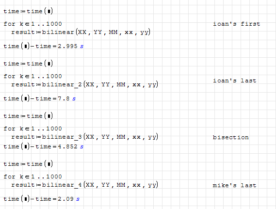

#13 Posted: 2/22/2014 7:53:47 AM
A test through the Margin() solutions... BTW IMHO is preferable a test with less iterations but bigger matrices...
[edit 1] file updated (previously missing xx and yy values on the canvas)
[edit 2] screenshot updated using the file above
![2014-02-23 02_48_16-SMath Studio Desktop - [bilinear-final i - mod.sm_].png](/en-US/files/Download/unGTxr/2014-02-23-02_48_16-SMath-Studio-Desktop---[bilinear-final-i---mod.sm_].png)
