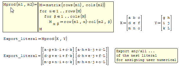

Hi. Something is wrong here, in both MProd functions, but can't figure what is it.
Thanks in advance.
Thanks in advance.
mprod bug.sm (12,4 КиБ) скачан 1533 раз(а).
Hello Alvaro, I can't explain the problem, but I see that it originates from the way arguments are passed to MDot.
See attachment, writing arguments directly into MDot gives correct result, passing through row() and col() gives an "a not defined" error.
It seems that using row() and/or col() a numerical evaluation is triggered, even if the region is marked as "Symbolic".
Sorry, I can't give a better explanation.
Marco
Marco
Hi. Enogh to know that problem it's in row and col functions. Even I can't write the code for them, seems to be solved the issue rewriting length function.
mprod_workaround.sm (7,99 КиБ) скачан 1449 раз(а).
Alvaro ... is that what you are looking for ?
Utilities Matrix Product[X,Y].sm (16,63 КиБ) скачан 1249 раз(а).
