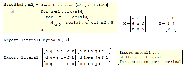

Hi. Something is wrong here, in both MProd functions, but can't figure what is it.
Thanks in advance.
Thanks in advance.
mprod bug.sm (12.4 KiB) downloaded 1566 time(s).
Hello Alvaro, I can't explain the problem, but I see that it originates from the way arguments are passed to MDot.
See attachment, writing arguments directly into MDot gives correct result, passing through row() and col() gives an "a not defined" error.
It seems that using row() and/or col() a numerical evaluation is triggered, even if the region is marked as "Symbolic".
Sorry, I can't give a better explanation.

Hi Marco. Thanks very much for your appointments. I go to take them in consideration for see the best way to extend dot product for some simple manipulations with symbolic algebra and taking the conjugate transpose instead the second argument.

Hi. Enogh to know that problem it's in row and col functions. Even I can't write the code for them, seems to be solved the issue rewriting length function.
mprod_workaround.sm (7.99 KiB) downloaded 1477 time(s).
Same solution it's used for Lagrange equations with vectors.
