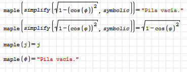

is this solution correct?
question_230609.sm (3,75 КиБ) скачан 1366 раз(а).
#2 Опубликовано: 08.06.2023 23:35:04
Obviously not, but the bug isn't that obvious: just avoid to use that 'phi' (j Ctrl-G):

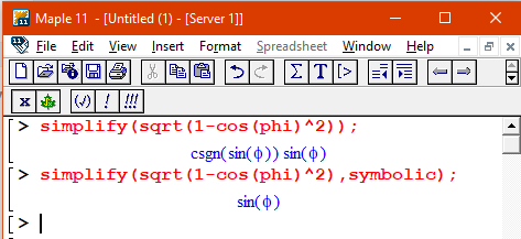

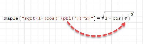

#5 Опубликовано: 09.06.2023 09:07:42
Yes, these are different letters:
cos(ϕ) and cos(φ)
maple() works with φ
This was done to unambiguously convert variables into Greek letters:
maple() function uses implicit encoding of Greek letters:
churichuro 09.06.2023 15:32:00

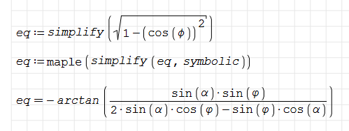

#6 Опубликовано: 09.06.2023 11:58:48
I think the result soomoon expects is this, but it requires a newer version of maple:

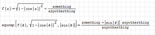

#8 Опубликовано: 12.06.2023 11:12:20
where can i get a new version of maple ?
Inside SMath, you can't. This is a workaround, valid for real values
