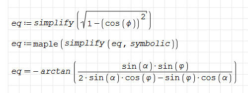

is this solution correct?
is this solution correct? - Messages
#1 Posted: 6/8/2023 9:04:50 PM
soomoon
soomoon
1 likes in 42 posts.
question_230609.sm (3.75 KiB) downloaded 1367 time(s).

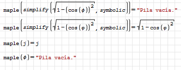

Obviously not, but the bug isn't that obvious: just avoid to use that 'phi' (j Ctrl-G):

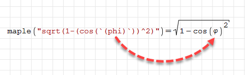

Yes, these are different letters:
cos(ϕ) and cos(φ)
maple() works with φ
This was done to unambiguously convert variables into Greek letters:
maple() function uses implicit encoding of Greek letters:

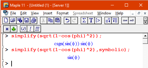

I think the result soomoon expects is this, but it requires a newer version of maple:
where can i get a new version of maple ?
#8 Posted: 6/12/2023 11:12:20 AM
1,139 likes in 1,805 posts.

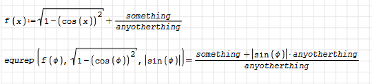

Inside SMath, you can't. This is a workaround, valid for real values
