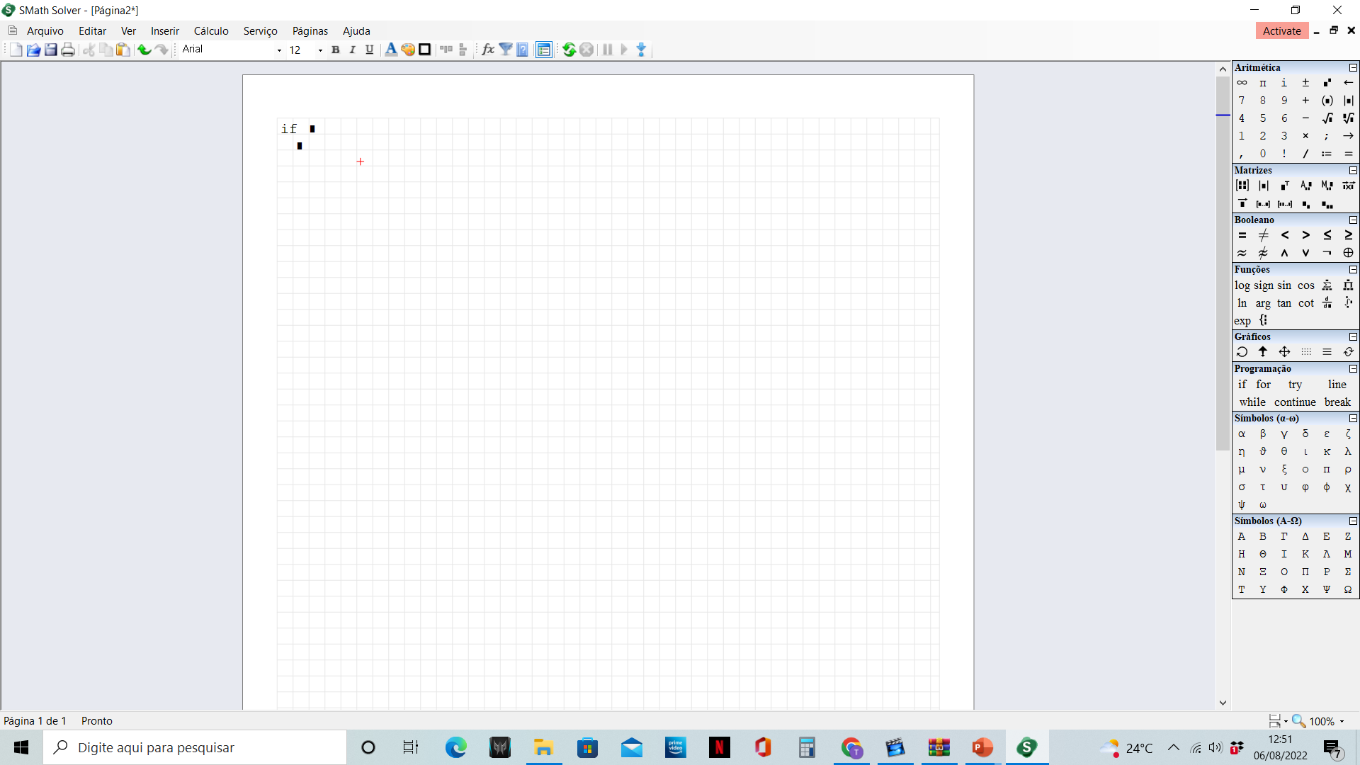

I´m having problems with the if function on the programming pallete. When I choose "if" from the pallete it just shows two lines, there is no else anymore like on the image in the attachment. If I recall correctly the else statement used to automatically appear when you choose the "if" function from the pallete. Could someone help me understand what´s happening?

First of all, check in Tools-Option-->Interface-->Arguments separators which setting you set up. They are possible "," "." ";".
Suppose it is ";".
In the placeholder digit once ";" to get Else or ";;" to get Elseif

Thank you! It worked
