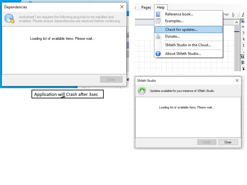

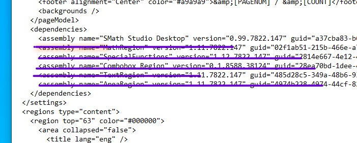

I have a similar issue; I am still using the 0.99 version, but the issue I noticed is with regards to management of versions (app and plugins) and shouldn't be ignored as version management is a HUGE perk of SMath; that it is backwards AND forwards compatible.
This is an annoying bug as it doesn't give you any context, it just closes the application after 3seconds of trying to update plugins (if you have sufficient plugin versions, it doesn't try to update, and it doesn't crash as a result:
There is an easy work-around, just to delete (or correct) the plugin dependents within the SMath file you are accessing.

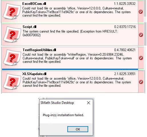

To the best of my knowledge, there are at lest (4) bad plugins that will not install:
  • "...\plugins\0370e95d-cfdf-4f76-96cb-468d63d765c0"
  • "...\plugins\a9f5e37d-83f5-4a4b-a106-0ba7b202abbb"
  • "...\plugins\e40eaef6-4622-4ef3-ad03-077e8f005bb1"
  • "...\plugins\20ad815b-bc5e-487d-9258-57fde2ac6de8"
I think the issue is that the program never addressed the possibility that a plugin that throws errors/doesn't work would ever be posted. As such, I believe that if ADMIN removes these (4) plugins from the online gallery, functionality of the 'checking for updates' will be restored:
May this be of Good Help;
