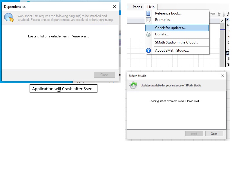

After I upgrade it to 1.0.8151, if I go to tools->plugins->plugins->online gallery and select any plugin to update, the app will crash.

This is an annoying bug as it doesn't give you any context, it just closes the application after 3seconds of trying to update plugins (if you have sufficient plugin versions, it doesn't try to update, and it doesn't crash as a result:

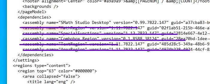

There is an easy work-around, just to delete (or correct) the plugin dependents within the SMath file you are accessing.

Thanks for that hint. That works concerning opening an existing file.
I downgraded SMath from the version 1.0.8348 to several older versions (alternately).
But, even if no file is open, SMath crashes if I call "Search for updates" or if I open the plugins dialogue and select "Online gallery".
It seems that this is the same problem described in the post above when a file is opened.

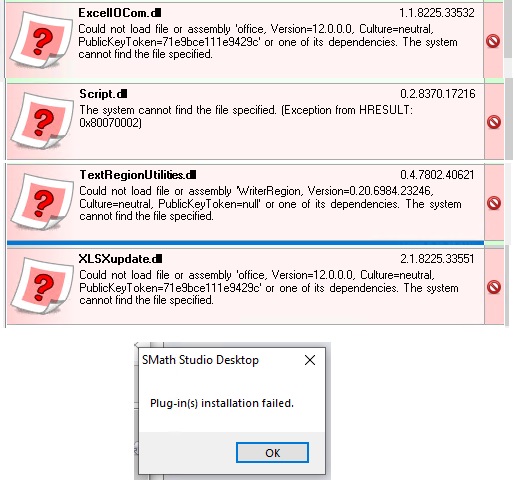

To the best of my knowledge, there are at lest (4) bad plugins that will not install:
  • "...\plugins\0370e95d-cfdf-4f76-96cb-468d63d765c0"
  • "...\plugins\a9f5e37d-83f5-4a4b-a106-0ba7b202abbb"
  • "...\plugins\e40eaef6-4622-4ef3-ad03-077e8f005bb1"
  • "...\plugins\20ad815b-bc5e-487d-9258-57fde2ac6de8"
I think the issue is that the program never addressed the possibility that a plugin that throws errors/doesn't work would ever be posted. As such, I believe that if ADMIN removes these (4) plugins from the online gallery, functionality of the 'checking for updates' will be restored:
